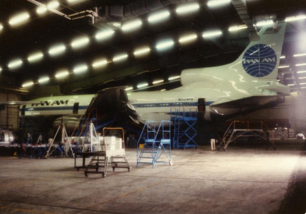

As to the L1011, this is the way I usually got to see them.
