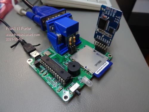

Posted: 08:10pm 01 May 2021
Here you can see my setup:
The only thing I notice is that you hear a soft noise from the piezo when you try to write the date or time. I will try it tomorrow with a pull-up...
Frank

Posted: 08:51am 02 May 2021
The single soft "pop" noise from the speaker is normal. It shares the same SCL line.
