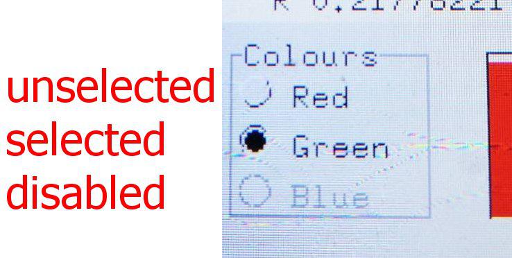

  lizby said
One thing I notice--perhaps it is because the the radio buttons are themselves red, green, and blue, but it's difficult to tell which one is selected.
OK, I think I got it - and you are right, it greatly improves clarity - Thanks!
the dot can still be any colour but it only shows when selected
Edited 2021-03-24 17:44 by CaptainBoing

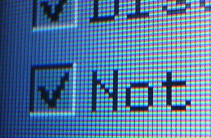

inside the main loop. Not graceful...but it works. Also, the check/unchecked area for checkboxes doesn't seem to scale correctly to the frame around it...minor cosmetic issue. I haven't played with this...since I don't understand the usage of GUI Bitmap currently.

I just discovered what was apparently changed in the Checkbox draw routine. The GUI_bitmap statements were x+2,y+2, but are now x,y. If I put it back to x+2,y+2 the checkboxes are perfect on my CMM2.
Steve
Posted: 08:45am 06 Apr 2021
Thanks Steve.
I have updated the code to provide your cursor controls inside the slider touch processor.
Can't see that the checkbox needs any tweaking? Could you grab a closeup on the CMM2?
