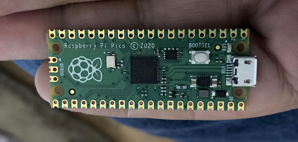

Posted: 10:06am 23 Jan 2021
  matherp said  FWIW IMHO
This chip is a dog. No floating point except S/W, no integer divide, only 32 bit multiply with 32-bit result (not even 64-bit result). Very limited subset of Thumb2 so lots of extra instructions for simple tasks
Other than the "Raspberry" name there is absolutely no reason I can see to use it over the ESP32 which is well supported and better in almost every aspect
The ESP32 does not have or run mmbasic is one reason.
the Esp32 doesn't have enough ports
I thought that seeing this one has programmable io ports maybe it could be used instead of the Pi if it had mmbasic on it
Rp2040 datasheet
It has a Fast single-precision floating point library.
I don't know what these mean but its 64bit as well as 32
The  processor  implements  the  ARMv6-M  Thumb  instruction  set,  including  a  number  of  32-bit  instructions  that  useThumb-2 technology. The ARMv6-M instruction set comprises: All of the 16-bit Thumb instructions from ARMv7-M excluding CBZ, CBNZ and IT. The 32-bit Thumb instructions BL, DMB, DSB, ISB, MRS and MSR.
No idea what thumb is or does
It's also Tiny - this is on my index finger
Edited 2021-01-23 20:13 by lew247

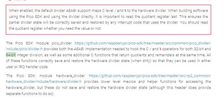

Posted: 02:55pm 23 Jan 2021
Quote from the pico_c_sdk.pdf datasheet, page 25
The SDK includes optimized 32 and 64 bit division functions accelerated by the RP2040 hardware divider.
There are graphs in the datasheet showing that the 64-bit divides are typically twelve to twenty times faster than can be accomplished by the M0 core alone.
Edited 2021-01-24 00:55 by ceptimus
Posts: 12084
Posted: 03:16pm 23 Jan 2021
  Quote  There are graphs in the datasheet showing that the 64-bit divides are typically twelve to twenty times faster than can be accomplished by the M0 core alone.
Yes understood - but that is just integer divide - no FPU just some ROM software of unknown provenance
Everyone will make up their own mind but for me this is a poor imitation of the ESP32 and has little of no advantage over a normal ARM processor such as packaged by ST. Why did they not just use the M4 core and then there would be no need for a one-function co-processor?
ceptimus
Joined: 05/07/2019
Posts: 130
Posted: 03:26pm 23 Jan 2021
I don't think it's just ROM software.  It's a piece of hardware that does multiplication and division.
I suspect this is just the first in the line of Raspberry Pi products that will eventually allow them to release something much more powerful that doesn't rely on the Broadcom-specific chip with it's closed hardware and firmware.
Judging on the Raspberry Pi foundation's past performance, there are almost sure to be future Pi Pico models 2, 3, 4, ... and these will no doubt have better, faster processors with more RAM, Flash, etc.
Edited 2021-01-24 01:30 by ceptimus
