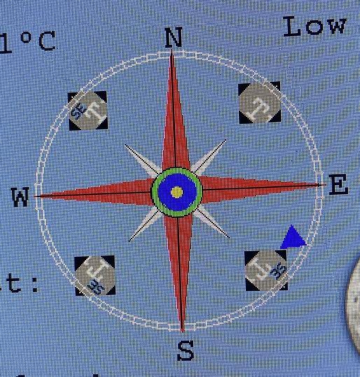

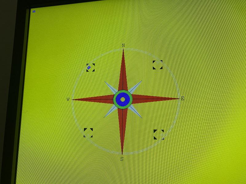

If you see this post, have you any idea why I'm getting the black triangles around the intermediate directions?
I've quite possible made an error when adapting your code.
There's also a "spare" blue rectangle in the top left corner, not sure if that's related to the code or not, it doesn't appear when I run the weather code that doesn't have the image rotate section in it
I made it yellow so it's easier to see the artifacts, and it's an up close shot of the screen

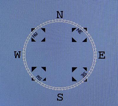

and when I update the colours so it's the right ones it becomes this
I've made a set of images with the intermediate directions rotated to the correct angles on them
I don't suppose you know a formula to work out where to place them on the screen in the correct place without doing it by trial and error?

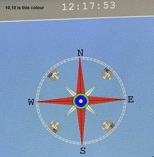

Peter:
Have you any idea why this happens?
The image rotate when it's redrawn always uses the colours located around 10,10
If I use any other location to write the text as in the examples below I get this
As you can see I tried using 540,110 to do the text so it got the background from there but  as you can see it doesn't work
Also the black corners I can't remove
Any suggestions?

The reason it's getting the grey is because I have a box in the top panel
BOX 0,0,mm.hres,mm.vres/16,1,RGB(WHITE),RGB(162, 160, 160 )' top panel
Edited 2021-01-09 21:34 by lew247
