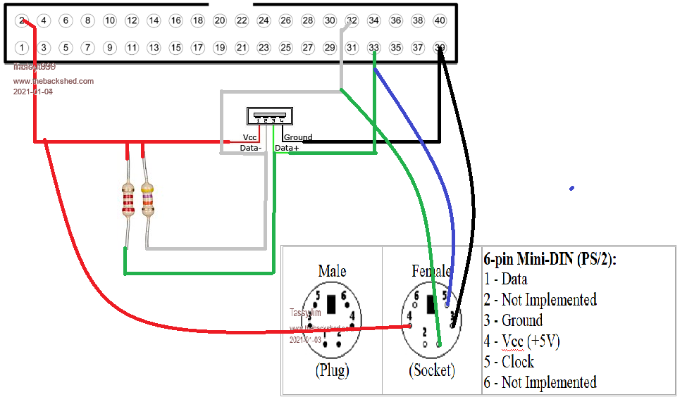

Is the resistor on the right 100 Ohms (Yellow, Purple, Orange)? What about the one on the left? I can't really tell the colors from the photo.
Sorry,
I just grabbed an image of 2 resistors.
4.7k to 10k should be good.
I will try and be more careful in future.

  matherp said  Both resistors should be 4K7 but the value is nor critical
  Quote  One question though is there any performance differences between the two options, ie. Native PS/2 mouse and HT mouse?
The Hobbytronic mouse is polled every 16mSec. The PS2 mouse is completely interrupt driven. So if you don't move a PS2 mouse it has no overhead but when it is moving the overhead may be slightly more as each clock causes an interrupt

  TassyJim said  If you are using a USB mouse, there is no need for the adapter.
I was thinking of making a cable with both the USB port and the PS/2 port on it.  Then you could plug in either type that would work.  Would that be doable without me killing my CMM2. I think that would be the best cable to make if it is safe. Could you make a diagram of that kind of cable? I am still gun-shy about connecting anything to the GPIO. Thanks Jim.

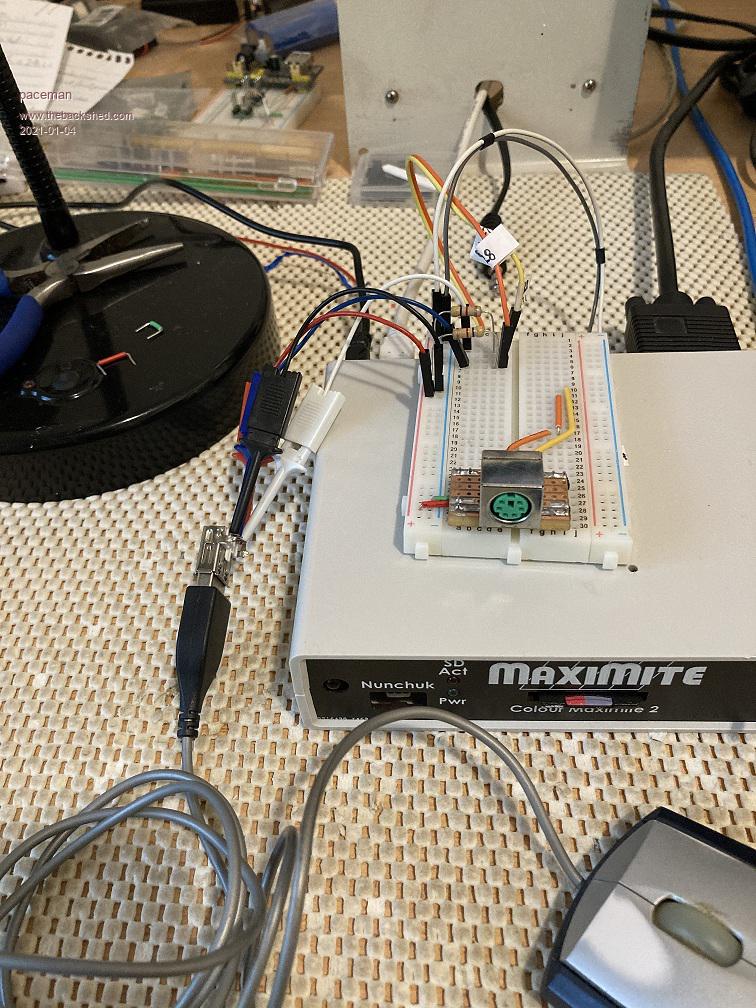

Just connected my 10 year old Porto optical USB mouse up as per Jim's diagram (no adapter) and it worked first go - I'm amazed how clever I am!    Peter's test program came up with my mouse as a Type 3, whatever that means, and it's working fine in the file manager and editor.
My only regret is there's not much point now posting a photo of my little PS2 breadboard adapter that took me about a full day to make - it's so neat too.

  paceman said  My only regret is there's not much point now posting a photo of my little PS2 breadboard adapter that took me about a full day to make - it's so neat too.
I'm formally requesting that you post a photo of your PS2 breadboard adapter because of said "neatness". You made it with pride - post a picture to share!

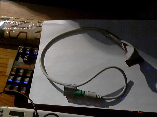

Hi.  I am trying to figure out how to make a cable with both connectors here is what I have so far.  Please advise.
Would this work and be a safe interphase.  I like the idea of being able to directly plug in the USB/PS/2 mice OR the strictly PS/2 mice with one cable.  I would appreciate the verification before I make the thing.  Thanks.
Posted: 07:53pm 03 Jan 2021
  Quote    I am trying to figure out how to make a cable with both connectors here is what I have so far.  Please advise.
Yes that would work. PS/2 is slow so there shouldn't be any issues with reflections from the open unterminated socket.
I had considered doing the same but decided that one socket and an adapter prevents accidentally plugging both in at the same time.
Edited 2021-01-04 05:53 by TassyJim

  Quote  PS/2 is slow so there shouldn't be any issues with reflections from the open unterminated socket.
 Is there anything I can do to fix that issue? I thought about the issue of duel plugins but I think it is worth it to have a universal cable for all my Mice.  Thanks.

  Quote   Is there anything I can do to fix that issue? I thought about the issue of duel plugins but I think it is worth it to have a universal cable for all my Mice.  Thanks.
I said it should NOT be an issue. If you accidentally plug both devices in, it shouldn't damage anything but definitely not work.
It depends if you are going to be swapping mice a lot or, now that I have things working, I am unlikely to do any swapping.

  Quote  I said it should NOT be an issue. If you accidentally plug both devices in, it shouldn't damage anything but definitely not work.
 I went another way and it is much more streamlined so I will stay with this little guy. Works for some of those MS mice but not some of you others.  Not a big deal.

  mclout999 said
  Quote  If you are using a USB mouse, there is no need for the adapter.
This one kind of confuses me.  If you are using a USB mouse don't you need the HT USB host or am I missing somthing?
Jim, You make the best wiring diagrams but can you give one with the proper connections to the PS/2 female port.  Thanks.
If you have a USB mouse, use the diagram posted in this thread. You don't need the PS/2 port at all. All you need is a USB breakout, two resistors and some wire. That eliminates compatibility problems with some USB mouse - PS/2 adapter combinations.

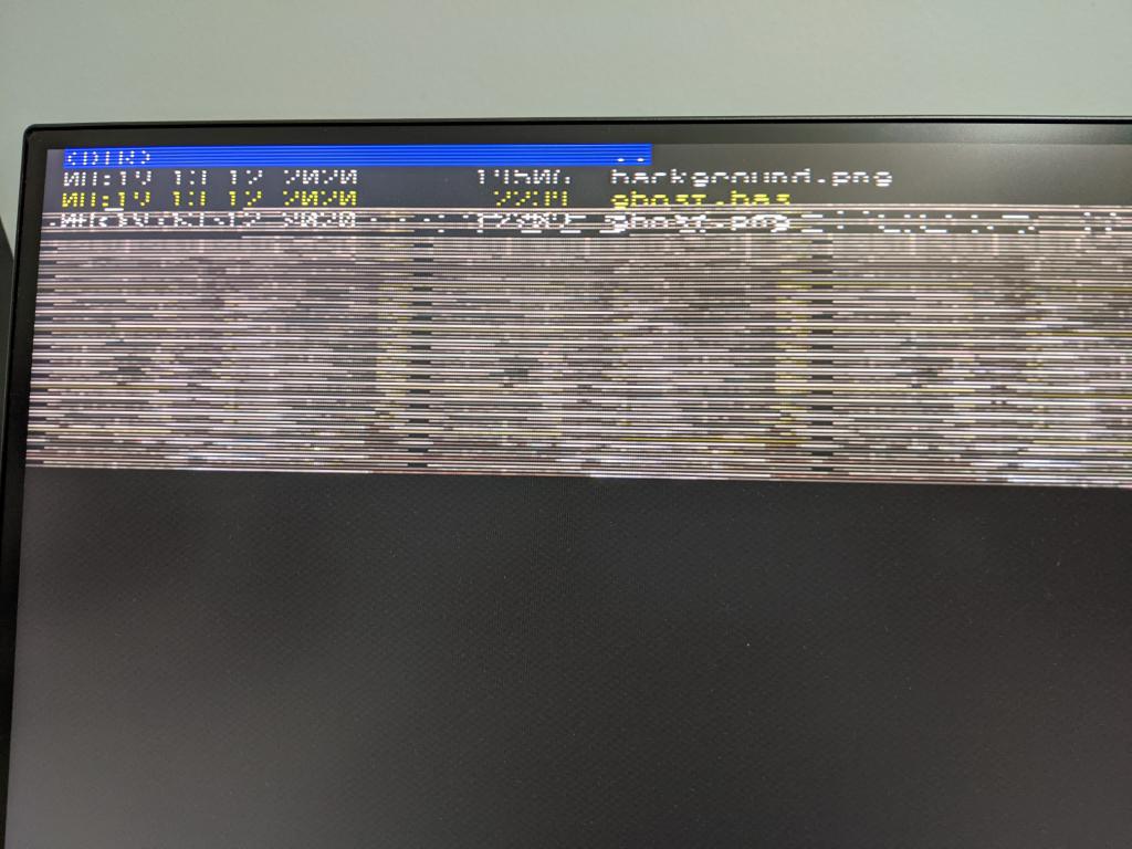

Does anyone else have graphical glitches with new beta firmware, or is it my CMM2 playing tricks on me? I have odd artefacts with graphics demos in Welcome tape, and the main menu does not work - I can't select any menu item as neither cursors or numbers do work. The keyboard works Ok in other cases.

There is a problem that seems to be related specifically to the way the welcome code works. Let me know if you see the same in any simpler program as that would help locate the issue

For the keyboard issue, I have it only with Welcome tape 0.5.1. I'll check some other software later on and report (IIRC, ran some games and they were fine, but let me double check and more thoroughly).

Sorry but I'm not able to be very active on the CMM2 or Welcome Tape at the moment.
@Rado how did you run the example shown in the YouTube video if the menu/keyboard was non-functional? Did you just run the .bas file directly, if so then @matherp I don't believe there is any Welcome Tape *magic* involved, and that it is just your original buckyball example code.
If it is the Welcome Tape *magic* then my prime suspect would be a firmware change that has hit the behaviour of EXECUTE.
To see if this is the case try changing we.run_program() in "/welcome/common/welcome.inc" to:
Sub we.run_program(f$, cmdline$)
 Mode 1,8
 Page Write 0
 Cls
 Print : Print "Loading '"; f$; "'..."
'  Execute("Run " + Chr$(34) + f$ + Chr$(34) + ", " + cmdline$)
 Open "/welcome.tmp" For Output As #3
 Print #3, "Run " + Chr$(34) + f$ + Chr$(34) + ", " + cmdline$
 Close #3
 Run "/welcome.tmp"
Thanks CG, here it is, along with the USB connections sans adapter. Now to make them neat!
Greg

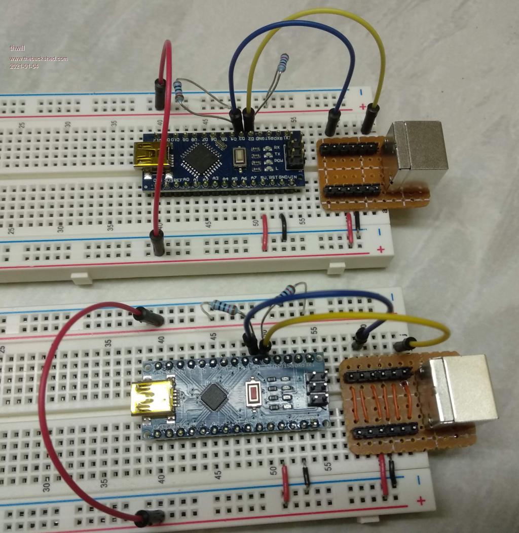

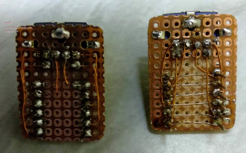

Posted: 11:35am 04 Jan 2021
Nice.
I felt much the same pang of regret:
... though looking at the underside magnified to such an extent I'm less pleased with my soldering now.
