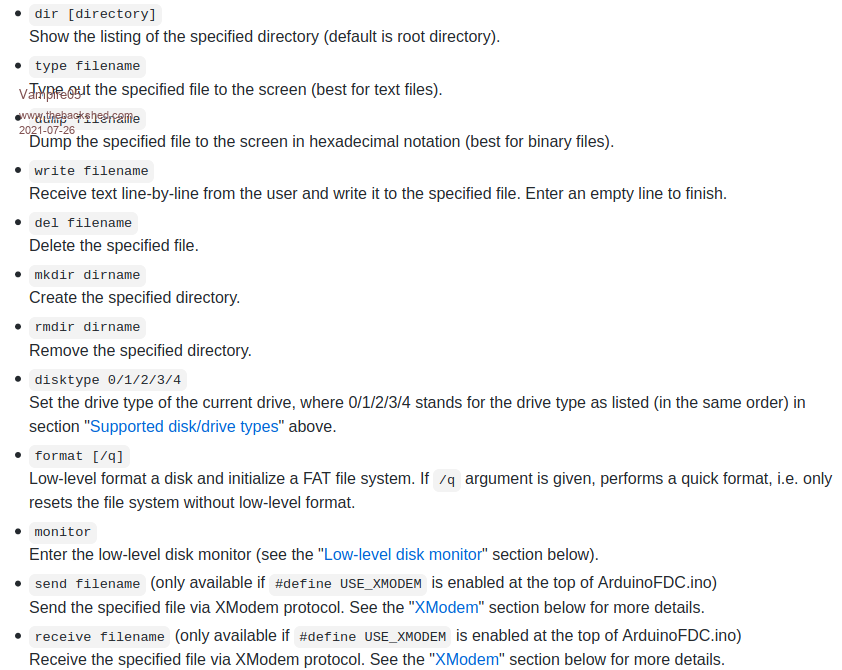

Hi Guys,
yesterday i have tried the arduino floppy (ArduinoFDC) with ArduDOS, it works great. Here the ArduDOS Commands:
The both XMODEM commands "send filename" and "receive filename" sounds interesting for data exchange between floppy and CMM2. I have two questions:
1) Is it possible to use the XMODEM command on the CMM2 to send and receive ANY filetype over COM1? (Not only .BAS files)
2) Is there an easy way to store some MMBASIC Functions in the flash memory of CMM2? My Idea is, save the floppy driver in the flash and not on the SD Card.
Best regards
Edited 2021-07-26 18:43 by Vampire05

Posted: 08:26pm 26 Jul 2021
AFAIK you can send any sort of file using XMODEM, but I don't think the CMM2 makes any sense of file extensions and will treat them all as ASCII. I might be wrong.
There's no user access to the flash on the CMM2 where MMBasic is stored. There is a 4k  area of battery-backed RAM used by VAR which might be of some use, otherwise all storage is on the SD card. The main RAM is overwritten by the editor when there is no program running. When a program is run it is first copied into main RAM, overwriting the editor, then run.
Posted: 08:54pm 26 Jul 2021
XMODEM will send/receive any file type. Just be aware that the file will get padded with chr$(27) or chr$(0) to bring the file up to a multiple of 128 bytes. Which padding gets used depends on the particular implementation and you have to handle either.
This is not usually a problem for programs and images but can cause grief with files that get appended to such as log files. You will have to code around it.
