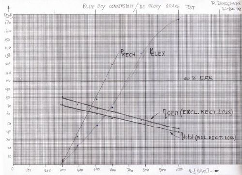

Thanks a lot for making all those measurements and publishing it here. Very valuable information. First time I've seen this kind of information for a larger motorconversion. And yes, indivdual rectification of all phases would have been very interesting information too...
I had one conversion that worked perfectly in delta; on attaching a scope, it turned out to put out near-perfect sinewaves, i.e. very little harmonic distortion. I figure the problems we see in practice with delta is not because of delta causing circulating currents in itself, but because of non-sinusoïd waveshapes with 3rd order distortion, which, in delta, can cause circulating currents.
Your efficencies are quite a bit lower than what I expected and hoped for, but considering that you're using the original windings (high voltage, thus high resistance) it's not very surprizing. You say:
[quote=Steven] You could make a case for re-winding the stator with greater wire gauge. If a prop can be matched to the input power curve as it is, however, there might not be much benefit to re-winding when all is said and done.[/quote]
Matching to the input power curve needs to be done anyway... but if rewinding gives you effiencies in the range of 80-50% (as for my small 500W conversion) I think it'd be worth it. You'd still need to match to the blade, but you get more electrical output power and less wasted heat in the conversion. But that's just me. You know, there *is* a reason that people go through the trouble of rewinding... it's not just a way to keep busy... Rewinding, though not hard (if you can get the materials), is quite a bit more work. With the current winding it may indeed be a better way to utilize it for water heating, not battery charging.
Here are the measured curves for a much smaller conversion, but one that was rewound. The efficiencies are quite a bit higher... so I think rewinding is worth the effort:
