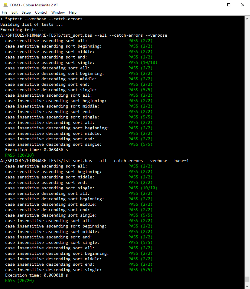

Posted: 04:12pm 30 Nov 2020
  matherp said  V5.06.00b9
http://geoffg.net/Downloads/Maximite/CMM2_Beta.zip
You're killing me, or I'm killing you, you've fixed one bug and I think (as far as string arrays and my unit-tests for SORT go) there is only one bug left.
Using the same example as before, run with the base=1 command line argument:
Colour Maximite 2
MMBasic Version 5.06.00b9
Copyright 2011-2020 Geoff Graham
Copyright 2016-2020 Peter Mather
> *sort_bug_3 base=1
Option Base = 1
Sort element 1: one two three four five
Sort element 2: one two three four five
Sort element 3: one two three four five
Sort element 4: one two three four five
Sort element 5:
Error in line 18: 5 is invalid (valid is 1 to 4)

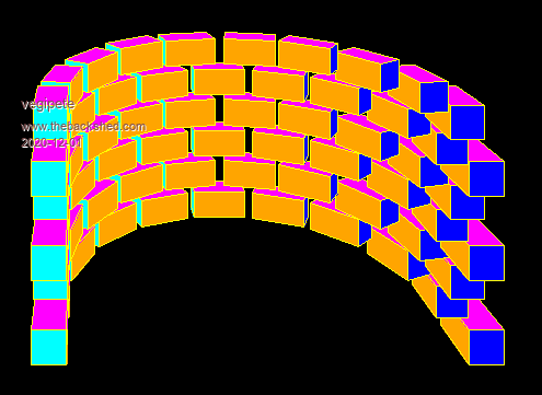

Posted: 02:10am 01 Dec 2020
This 3D engine is fun stuff!
Peter gave us a brick wall above. But I wanted a curved wall:
There is an obvious problem in that I have to draw the bricks from farthest to nearest. (Ugghh)
A less obvious problem is in the projection. The blue faces of the bricks on the right side in particular look far too square. Something seems wrong with the projection. Have I set the viewing plane or viewing distance too near or too far?
CurvedBrickWall.zip

Posted: 05:25am 01 Dec 2020
Nice curved wall VegiPete. It seems that the Painter's Algorithm is wrong for the right side of the wall.

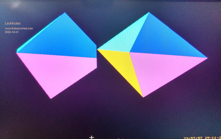

I also sow a rendering problem in the octahedron example.
The right side of the left octahedron is being cut by the right octahedron.

  Quote  I also sow a rendering problem in the octahedron example.
This is because the example code is incorrect and needs fixings for the corrected rendering

Tom, LOVE that you set up a unit test framework!!  Probably not as useful for visual things (ie how do you automatically test to see if the result of graphical commands are correct?) but still very useful for running through the various other commands and ensuring that they haven’t broken or changed in behavior.  I know the Java developers use a similar huge set of tests as they develop the language to ensure they didn’t break things as they add new capabilities in, and to test that new features are working as intended.
I really need to pull down your tools and have a go with them.. Just need to find some time to devote to CMM2 stuff...
mkopack73
Joined: 03/07/2020
Posts: 261
Posted: 01:37pm 01 Dec 2020
And should also say that Peter I love where you are going with this! This is very much in line with what I had wanted to develop myself, just didn’t have the time...(too many other projects!!!)
Question about the 64 vertices /64 faces - is that total for the object or is it 64 vertices PER face? (So a total of 64*64 vertices possible?)
Posted: 02:20pm 01 Dec 2020
  mkopack73 said  Tom, LOVE that you set up a unit test framework!!  ...
I really need to pull down your tools and have a go with them ...
Thanks.
My tools are very much under active development at the moment. If you do pull the code then make sure it is from https://github.com/thwill1000/sptools/tree/develop-r1b3 and not the "master" branch which is very out of date. Please also be aware that since it is a single-developer project I am being "naughty" and doing updates with forced pushes to that branch, something I would never do in "master" or shard branches in public projects.
Edited 2020-12-02 00:22 by thwill
