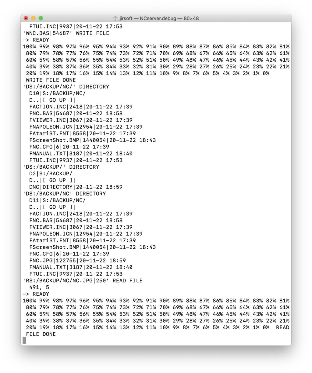

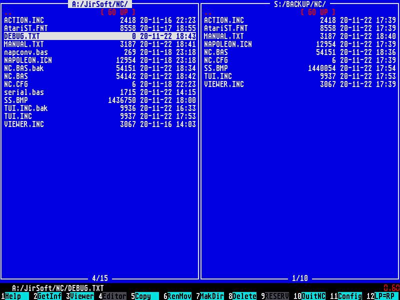

Some BIG news (at least for my workflow): NC now can copy between local SD card and server running on other machine connected with CMM2 through serial (now just tested on Mac), so you can BACKUP, EDIT on both, put easy to GIT...
You just need to use OPTION CONSOLE SCREEN + OPTION CONSOLE SAVE to leave serial for server, start server on PC and it's done. Tested with baud rate 230400 and it's usable.
I will prepare server description (so every can programmed his own in preferred language), in the meantime I will put to GITHub binary for Mac and try to write it in Python.
Some other changes:
      character keys now jumps first to directory with this letter on start, second press to files
      waiting dialog now can have progress bar (usable on server copy   )
      some bug fixes (thanks to everybody who put here bug info for help)
If somebody feature request, just put it here.
Jiri
