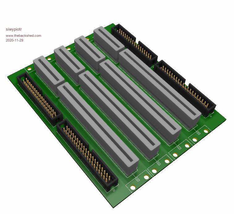

  siwypiotr said  You are correct about shift register.
...... (shift registers on the cards will be daisy chained).
This is one of the cards that will be soon available:
- relay card
- bread board card (for fast protoyping)
- power card (highly efficient delivery of 3.3V, 5V, 12V, 24V)
- wire communication card (USB mouse, RS232, RS485, CAN BUS)
- wireless communication card (WiFi, GSM, RFM - LORA)
And I hope that many more including those created by other people.
For filtering of ESP it is too late, boards will be delivered next week so It looks like we will see.
Good to hear that someone knows where Poland is :) Im located near Katowice city, 80km west from Krakow.

  Paul_L said
Edge connectors are used extensively in Boeing aircraft, particularly in the Delco INS computers and the digital Bendix autopilot computers. They are extremely reliable and are relatively easy to clean. I don't like the individual pins and sockets which are so prominent today in the piggyback boards.
Oooo I did not know it so it looks like You will like it also.
  Paul_L said
I see that you are trying to control a bunch of small motors. Inrush currents are a problem when starting ac motors, even very small ones. Switching on a TRIAC for a successively increasing duty cycle during each half cycle is the best way to accelerate the motor. It should be simple to control the successively changing trigger points programmatically. After a few seconds you could pull in a mechanical relay which would bypass the TRIAC and eliminate it's continuous voltage drop and self heating while the motor is running. Stopping the motor would entail simply dropping out the mechanical relay after which the TRIAC would block at the next zero crossing point. This should eliminate any arcing of the mechanical contacts on shutdown.
In fact Im not planning to control anything, Im making those card for other people to find use for it. Im not sure for what customers will use it, they can use it for AC or DC, that is why Im not sure if I should add any arcing suppression (due to inductive nature of controlled device) or zero crossing circuit (I do not know how to build it so it works for both AC and DC usages)

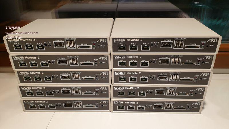

Posted: 08:31am 20 Nov 2020
It is possible that this is the last batch of Maximite that I made.
All of them I will ship with random gifts like (apart of SD card, USB cable, ESP WiFi, Mouse controller):
VGA to HDMI converter
NES controller
Nunchuk controller
VGA cable
https://sklep.pslabs.pl/Colour-Maximite-2-Deluxe-Edition-USB-Host-Contr-WiFi-p150?fbclid=IwAR15PxVSOcWdjtZHok9MINe03HlfI_iPvYUit7yYpl21YGtD8aicQkRIxEU
Since many people asked the question i would like to make small update. It is not that I scrap the project, design is finished and there is nothing that I can change to make it better. The project is and will be supported now and in the future. I need some time to develop other products like expansion system for Maximite and some gadgets for Atari ST.
It is also possible that if I will find some time I will make another batch but to do that I would like to hear from everyone if they are interested.

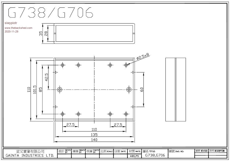

Hi
I finally found little time to continue on my expansion system for maximite. I would like to make it in size of standard Maximite 2, so it sits nicely on top of the unit.
I do not own original Maximite 2, could someone please measure original box size?
is it 139,5mm / 110 mm ?
Thank You for help.
romba6
Joined: 04/07/2020
Posts: 39
Posted: 03:06pm 28 Nov 2020
My top cover is 139mm, this includes the small radius. The 'flat' part is 132mm.
the other dimension is correct.
Edited 2020-11-29 01:07 by romba6
elk1984
Joined: 11/07/2020
Posts: 232
Posted: 03:14pm 28 Nov 2020
  romba6 said  My top cover is 139mm, this includes the small radius. The 'flat' part is 132mm.
Mine is W: 140mm x D: 110mm x H: 35mm
Again mine has a slight curvature on the top / sides.
siwypiotr
Joined: 18/08/2020
Location: Poland
Posts: 127
Posted: 03:22pm 28 Nov 2020
Thank You for help,
Is it possible that cover that producer used is similar to this?
If Yes that would be nice because i want to use (one of the half) as enclosure and it will sit perfect on the top of maximite.
Edited 2020-11-29 01:23 by siwypiotr
