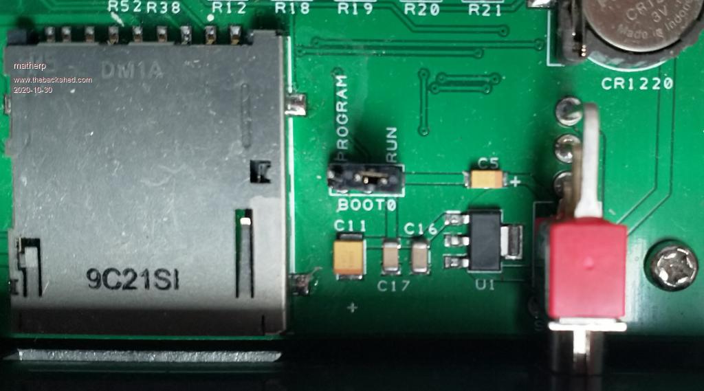

Googling the numbers:
'106C', this equals a capacitance value of 10 MicroFarad.
The first 2 digits are '10' and the multiplier factor is 1,000,000, so the value is 10,000,000pF or 10uF (10pF x 1,000,000= 10,000,000pF= 10uF).
Remember its a polarised type make sure you connect it the right way round.
No idea what the other numbers meant ... Manufacurers Code ???
I'm sure someone more knowledgeable will chip in soon with a part recommendation.
Edit: Using the BOM kindly supplied by Peter here is the details for C5 (yes its a 10uF tantalum) Datasheet

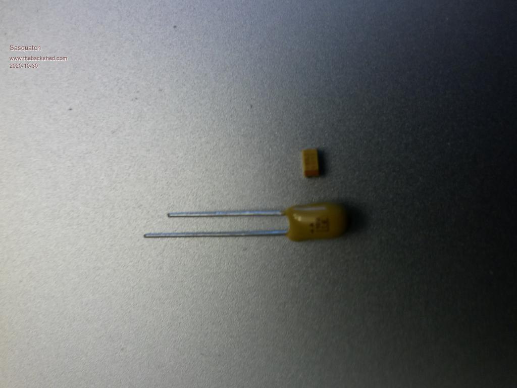

Posted: 03:24pm 29 Oct 2020
These are suitable replacements.  Sorry about the focus, that's about the best my phone camera can do.  The one with the "through hole" legs may be easier for a beginner to solder to the pads and is also a 16V rated part to avoid this happening again.  If you PM me your address I can put a couple in the mail for you!  As mentioned before, you will need to observe polarity or you will quickly fry the new part.  When in doubt "Google It"  If your power brick has a clean output, you might even get away without C5 for awhile.
Edited 2020-10-30 01:30 by Sasquatch

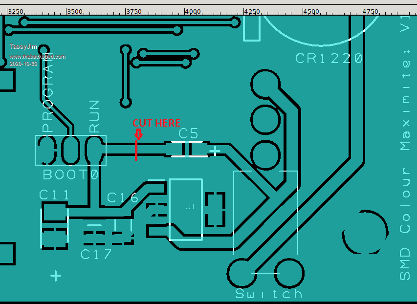

Posted: 08:16pm 29 Oct 2020
Please measure the voltages with the USB A-A cable in place.
If you can program the unit OK, the supply must be at least 4V to give enough voltage on the 3.3V side to allow programming to work. The regulator needs ~1.3V drop across it and the CPU probable will get away with 2.7V so 4V in 'should' work.
I don't think that the capacitor is faulty but as it's in the same circuit, measuring the voltages with power supplied via the A socket will confirm.
Faulty power supply, power supply limiting to 100mA, faulty cable, faulty B socket, faulty switch.

  TassyJim said  Please measure the voltages with the USB A-A cable in place.
Hopefully bad solder joint on one of the above.

Posted: 12:00am 30 Oct 2020
  Sasquatch said   If your power brick has a clean output, you might even get away without C5 for awhile.
What would you consider 'clean' and what risks would I be taking if it wasn't clean enough or became unclean...as it were?
Steve
Sasquatch
Joined: 08/05/2020
Posts: 385
Posted: 12:57am 30 Oct 2020
Steve
Well it's about ripple voltage, which you would need a oscilloscope to measure.  I'd remove C5 and try powering the CMM2 from a computer USB port, that should provide clean power.  Then try a known good power brick (something that has worked with the CMM2 before).  Removing the tantalum capacitor at C5 will tell you if it's just the capacitor or if the voltage regulator got toasted too.  It's very difficult to try to diagnose remotely.  I would think anything short of a bad CPU chip would be worth repairing.  As far as risk, you might see noise on the display or if the noise is bad enough it might not even boot.  I shouldn't think the output of power brick would be noisy enough to cause permanent damage as long as the voltage isn't too high.
Edited 2020-10-30 11:01 by Sasquatch
-Carl
Posted: 01:32am 30 Oct 2020
  yock1960 said
  TassyJim said
  Quote  With power on checks 2.3V
I find it hard to believe that you are able to program the firmware with voltages that low!
That will put the CPUs supply at 1 volt.
Well, I'm only going by the messages from what the software says, I really have no idea.
Steve
I do believe you, I just am very surprised that the CPU will operate so far below its design minimum.
I am also surprised that your PC didn't complain about the excess current drawn from the USB. They usually have a resettable fuse to limit the drain.
Rather than removing the capacitor, you could cut the trace on it's negative side. That would take it out of service and be easy to re-instate if that's not the problem.
On these boards, the large areas of fill on the top side are 3.3V while the fill areas on the bottom are ground. That means it is difficult to isolate the 3.3V side of the regulator.
If you cut where I have indicated, you can easily scrape off the mask either side of the cut and restore the capacitor with a blob of solder.
I don't have a SMD board so I am only going by the gerber files but I think you should have room to perform the operation.

yock1960
Joined: 18/08/2020
Posts: 167
Posted: 08:50am 30 Oct 2020
  TassyJim said
  yock1960 said
Steve
Well, it took several passes to cut through the trace and after I finally did, I had about 30 seconds of hope, as the busy light went out after powering on...but still no display. Voltage now checks about 1.7V on the center pin.
Another new development, is that when powering from the laptop to the B port, the device shows up as a com port now.
Further futzing around just now shows the busy light stays on after putting the run/prog jumper back on.
I installed Tera Term, set the port to 115200,8,1 and fired it up. Nothing. If I press the reset button while the terminal program is running, I get a few garbage characters back.
Cube programmer still connects...doesn't complain...I did not re-re-flash.
So, apparently, even though 9V should not have done this...it did...and the regulator is toast and maybe C5 and maybe...what else?
This was already going to be a challenge for me to remove and replace these components....time to punt?
Steve
