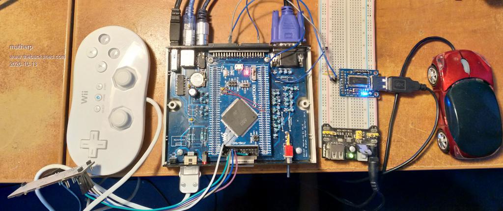

Posts: 12085
Posted: 05:34pm 12 Oct 2020
  Quote  This thread appears to be discussing a hardware variants, or is a variant defined as somethinbg that introduces non-standard behaviour to usage in MM Basic?  From what I can see above, the extra ports etc. are interfaced in standard ways (i2c etc) but are effectively giving extra headers.
I think the models shown here are interesting, but I'd be cautious about writing for anything for an extra port I couldn't achieve with a bit of wiring out of the GPIO.
As stated
  Quote   But anyway the implementation of the mouse I have done on one of the i2c ports available on gpio,
This board with the extra chip is exactly the same as my development machine with the Hobbytronic board plugged into pins 27 and 28 of the I/O connector just a little bit tidier

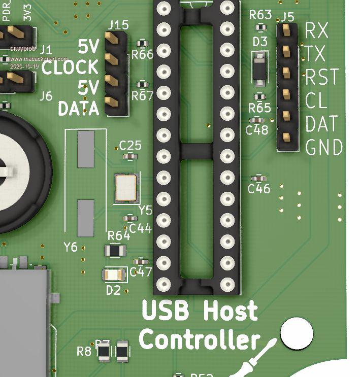

Hi
I have added place to install HobbyElectronic chip, there is dip socket, You just buy this chip and install it:
https://www.hobbytronics.co.uk/usb-host-dip?keyword=mouse
Arduino is not good idea for the mouse as it will work only with PS2 mouse and they are hard to find.
If You want to have arduino for whatever reason You can use the internal header to install it (extension boards are coming soon)
I meanwhile I will also work on my own USB mouse chip when done it will be open source.

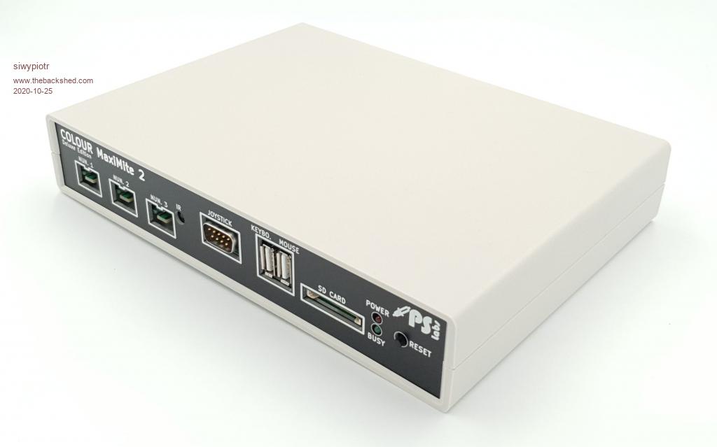

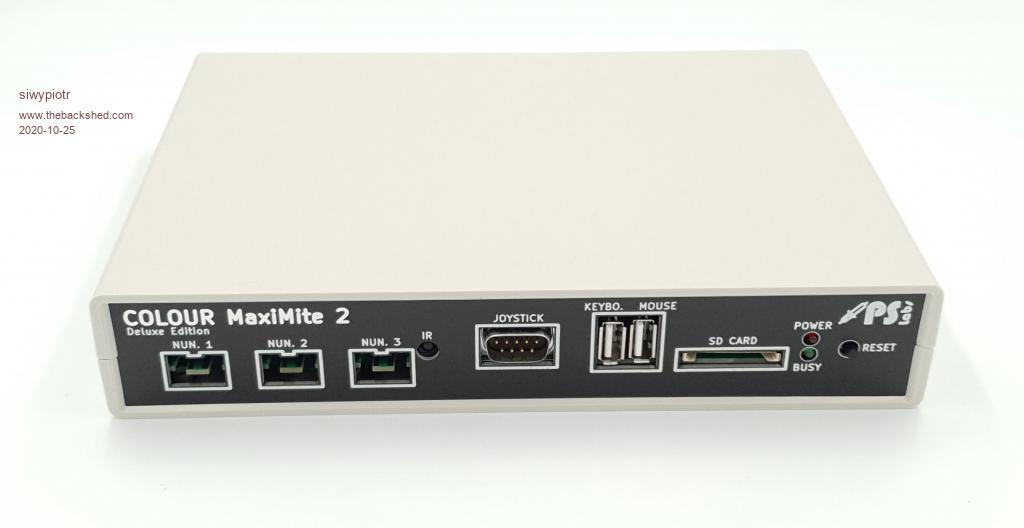

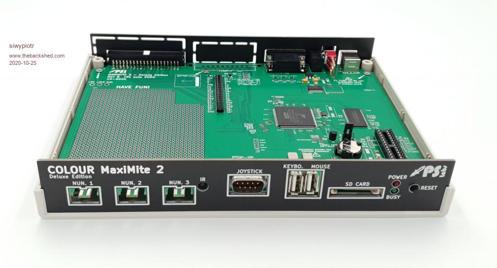

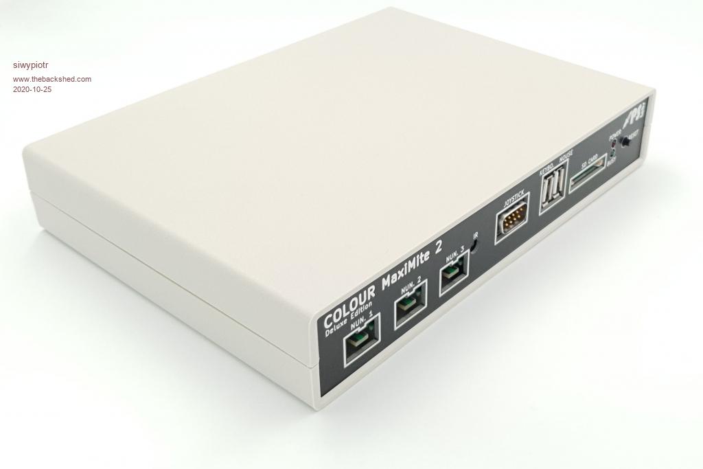

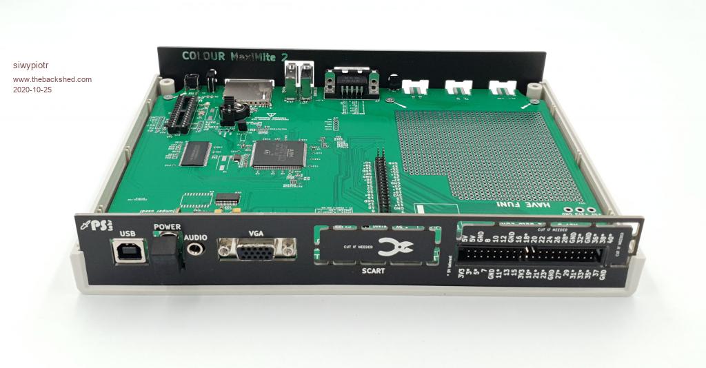

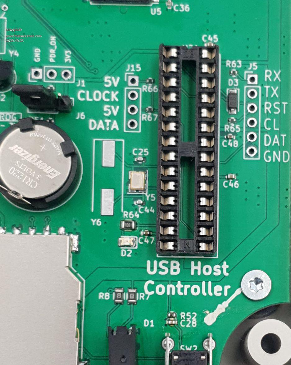

Posted: 10:42am 25 Oct 2020
Dear Maximite users
New version of Maximite 2 have arrived. USB mouse host controller dip socket is added as well as additional USB port for connecting mouse. Chip can be bought separately from:
Functionality however is not tested (my hobby chip have not arrived) however I do not see any problem for it to work.
There are still couple units left if You are interested in purchase.

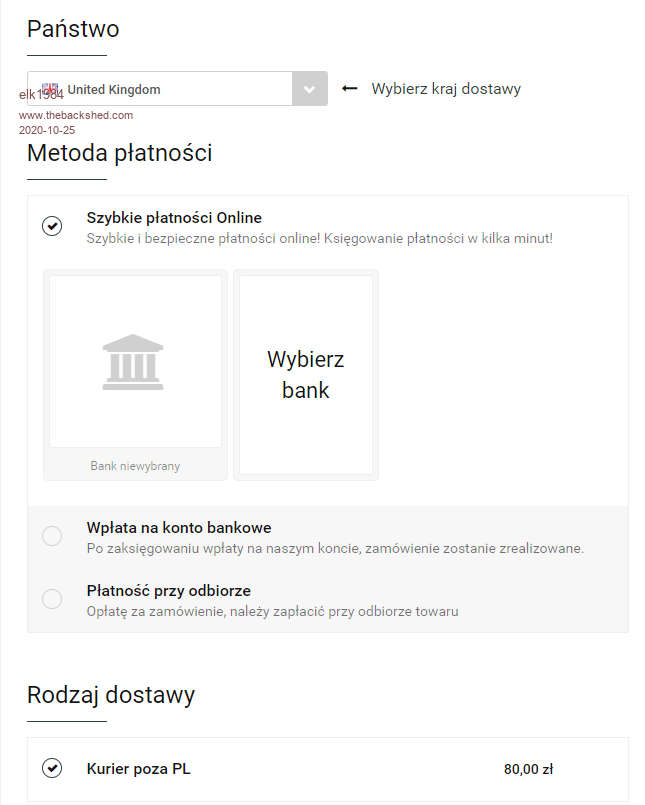

Posted: 11:21am 25 Oct 2020
  siwypiotr said  There are still couple units left if You are interested in purchase.
Hi, It looks great but my Polish isn't strong enough to get past the checkout page....

Posted: 11:28am 25 Oct 2020
Sorry for the web page, next week I will have some time and will make EN version.
I will send You private message and we will arrange everything

Posted: 03:28pm 25 Oct 2020
  William Leue said  I just got the shipping notice from CircuitGizmos for my RetroMax system. I am looking forward to having two built-in Nunchuk/Controller ports, and also room to add the HobbyTronic USB Mouse interface.
-Bill
Hi
Pictures above are showing Maximite 2 Deluxe Edition made by PS Labs

Posted: 07:24pm 25 Oct 2020
-Bill
I did too!
Is the USB mouse interface just a matter of plugging in a chip?

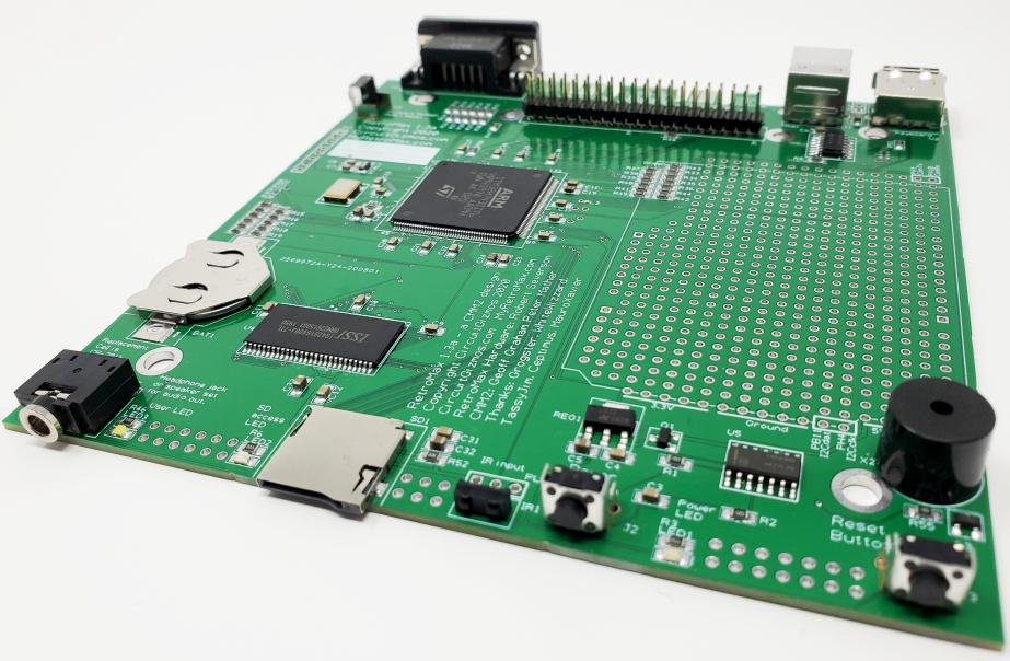

CircuitGizmos
Joined: 08/09/2011
Posts: 1427
Posted: 08:13pm 25 Oct 2020
  Krall said
I did too!
The CircuitGizmos RetroMax is a CMM2 compatible device. Please see:
https://circuitgizmos.com/RetroMax-CGs-Color-Maximite-2-p241231864
There are two different products from two different companies that people are assuming to have the same features.
Edited 2020-10-26 06:16 by CircuitGizmos

William Leue
Joined: 03/07/2020
Posts: 411
Posted: 03:51pm 26 Oct 2020
Yes, there are multiple similar products with somewhat different feature sets. I ordered mine from CircuitGizmos because I have already purchased a standard CMM2 from them and I like their service.
I have the HobbyTronic mini-board for supporting a USB mouse. But no, there is more to it than just plugging in a chip. You have to connect the control lines to one of the I2C circuits; this involves connecting power, ground, clock, and data lines. Also there is some software work needed in order to use the mouse with an application. I have not yet dug into all the details but I will post a report if and when I get it working.
