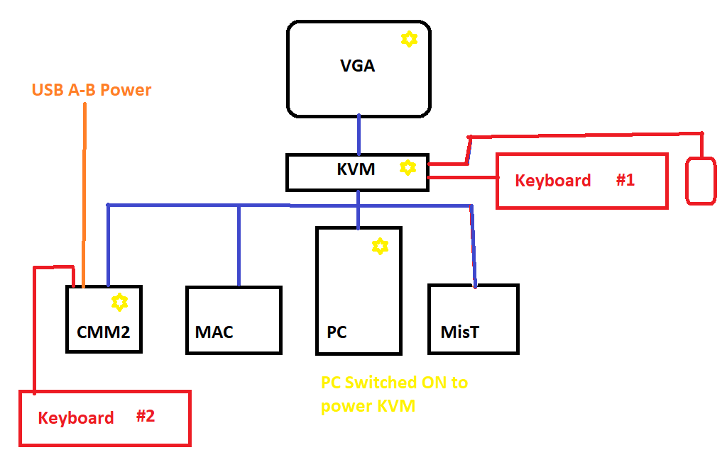

Unfortunately, the CMM2 will also not work through a KVM switch.
I have a VGA monitor with just one input port and a KVM switch to connect 4 computers with it (also they share one keyboard and one mouse). A Mac mini, a Raspberry Pi running RISC OS, and a MiST box are connected to the switch, using a wired Apple keyboard with a wired mouse attached to the keyboard. All work fine except the CMM2. I get the video through but not the keyboard. Since the KVM switch has several USB ports to route the keyboard I guess that means it acts as a hub.
I have a Lenovo keyboard that works fine when directly connected to the CMM2, but fails when replacing the Apple keyboard through the KVM switch. Do the only way to use the CMM2 is to unplug the VGA cable from the KVM switch each time and plug it in CMM2 directly and use the different keyboard. That will increase the wear and tear on the ports.
Anyone have tips or suggestions in this scenario?

Thanks for your input capsikin, but the KVM switch is powered through the USB port connected with the computer.
So if the USB cable is not connected the VGA signal is not passed on either. It seems I need to look for a different type of switch for the monitor and a separate solution for the keyboard I am afraid. I am not sure if a non-hub type  USB switch exists.

What KVM switch, it would be useful if you could link a picture or to the specs of the switch you are using.
Personally I would use the KVM to simply switch the video only (for the CMM2) and use an additional keyboard.  Source a small keyboard for the CMM2 if you are short of desk space.
Something like this:

I tried this, but sadly doesn't work.
It is this switch I have been using:
USB KVM VGA Switcher, AGPtEK 4 Ports USB 2.0 KVM Switch Box Adapter, One-Button Swapping, 4 VGA Cables included, Ideal for PCs, Keyboard, Mouse, Scanner, Printer & More
by Mambate Global
Learn more: https://www.amazon.co.uk/dp/B07BKYLYC8/ref=cm_sw_em_r_mt_btf_awdo_4bzoFb75V6A4C
Womble
Joined: 09/07/2020
Posts: 267
Posted: 09:05pm 16 Aug 2020
  Hendricus said  I tried this, but sadly doesn't work.
Ah, I can see why now.  It must be taking its power from whichever device its acting as the console for, and the CMM2 does not supply any power to it.
Not surprised it will not work as a keyboard for the CMM2, it has a usb hub built in to run a scanner/printer/etc.
You cannot connect a keyboard with a hub to the CMM2.
Shame that, it would have been a tidy solution.  My only suggestion would be a mechanical kvm switch.  This one from amazon might do the job if you have some spare vga cables to hook it up.  Experimentation would be required as I have not tested this personally.
You might be better served with a cheap 4:3 lcd monitor as that is the native aspect ratio for the CMM2 anyway and most modern montors are widescreen.  I picked up a brand new in box 19" Iiyama for £20 on ebay for use with my CMM2.  Could be cheaper in the long run.

So you can't leave the KVM USB cable that goes with the CMM2's VGA cable unplugged, but you could plug it into something other than the CMM2. The Mac or one of the other computers perhaps, or maybe (if it works) a USB power supply.

  capsikin said  So you can't leave the KVM USB cable that goes with the CMM2's VGA cable unplugged, but you could plug it into something other than the CMM2. The Mac or one of the other computers perhaps, or maybe (if it works) a USB power supply.
Thats pretty much what I was suggesting in yellow on my diagram.  Apparently that solution does not work.

I'm not sure if we're talking about the same thing. So 2 of the USB cables from the KVM switch are plugged into the PC right? The one with the PC's VGA connection and the one with the CMM2's VGA connection? That's not obvious from the diagram.

  capsikin said  I'm not sure if we're talking about the same thing. So 2 of the USB cables from the KVM switch are plugged into the PC right? The one with the PC's VGA connection and the one with the CMM2's VGA connection? That's not obvious from the diagram.
Ah, no that was not what I meant.  But its a good idea.
One for Hendricus to try ...
EDIT: although that would leave the PC keyboard still "live"

Thank you capsikin.
Using the Mac mini to serve as USB power source for the KVM channel for the CMM2 works! Just plug in the Lenovo keyboard directly into the CMM2 and then switch the KVM back to the CMM2 for the VGA signal to pass through works well.

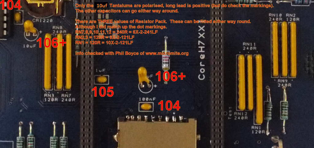

Hi I am having very odd keyboard behaviour. It starts repeating the last keystroke when not being pressed. I have tried several keyboards, same result. I tried another power cable, same result.
I have assembled the Silicon Chip Mag board.
It does have one thing that has me concerned. The tantalum caps have been substituted for a non polarised type, what impact does this have on the USB serial end of things?. I have not seen the circuit so can't draw my own conclusions.  Is a larger value or electrolytic an option?
Cheers Shed Dwellers .

  xmarkf said  I have assembled the Silicon Chip Mag board.

I also have a v2.1 PCB which I picked up as a spare.  I believe this is the version that comes with the Silicon Chip Kit (from looking at the magazine photos).
The capacitor markings on the silkscreen are the same.
Only the 10uf Tantalums are polarised, long lead is positive (but do check the markings).
The other capacitors can go either way around, I believe they are MLCC types.
Capacitor Markings:
10uF = 106+ (polarised Tantalum)
100nF = 104 (can go either way round)
1uF = 105 (can go either way round)
