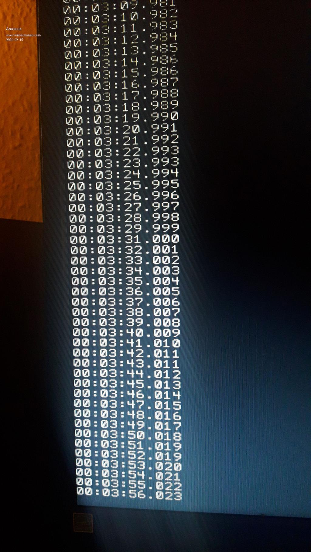

just to be pedantic run the following:
option milliseconds on
do
pause 1000
print time$
loop
is the time incrementing by 1 second +/- 2 mSec?
Amnesie
Joined: 30/06/2020
Posts: 763
Posted: 10:05pm 14 Jul 2020
  matherp said  just to be pedantic run the following:
do
pause 1000
print time$
loop
Here it is...
Posts: 6626
Posted: 10:38pm 14 Jul 2020
Your timing looks good so that is not the problem.

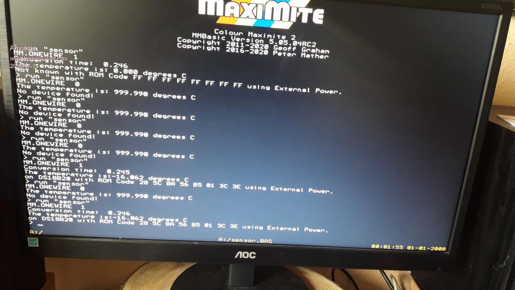

Amnesie
Joined: 30/06/2020
Posts: 763
Posted: 09:55am 15 Jul 2020
Hi,
thank you Jim for the help, my ds18b20 is reacting every time different. On the image you can see all kinds of errors. :(
I attached my ds18b20 libarary, which works for all my sensors on the atmega328p below (maybe anyone can spot a difference?)
@ Volhout, no I am using just one ds18b20 at a time. I am used to this sensors from my atmega328 projects, so at least, I know how to work with them on the atmega328p (there all three work). I just mention three because I have got all the tested individualy with the maximite. None of the works all the time.
On the image, you can see 3 different "states" / possible readings (I don't know how to call it), over the time, all those redings are repeating in a coincitential sequence.
I took a picture, so you can see all three  possible readings.
It is interesting, that with this program, the temperature isn't correct (if it has found the sensor). -16,062°C? Also the ROM Code appears to be whether FF FF FF ...
or 28 5C BA 56 .....
Now
With this library for my atmega328 all three sensors work! Just in case you can see some differences...
Edited 2020-07-15 20:09 by Amnesie

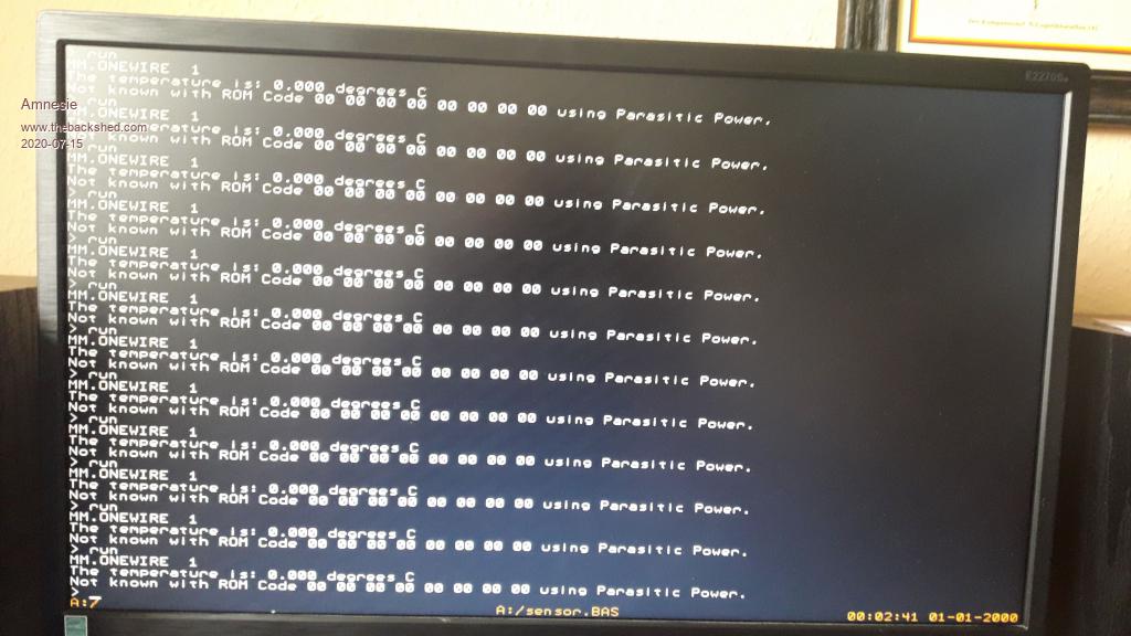

Amnesie
Joined: 30/06/2020
Posts: 763
Posted: 10:54am 15 Jul 2020
In parasitic mode I get not one single correct reading at all!

Would be interesting, if there is a different approach in "my" library than in the maximite one - although I am sure that Peter doesn't used a premade library, instead coded it all by himself.
I am curious whether my just ordered original ds18b20 will work...
Just in case anybody is interested, with this library, all my sensors do work:
ds18b20.zip
@ Rob
  Quote  try hooking the DATA pin of the DS18B20 to a 5v tolerant pin (3, 5, 11, etc) on the CMM2, and run both the 4k7 pullup and the Vdd pin of the DS18B20 to 5v (pin 2 or 4 on the 40-pin connector).
I posted this in an earlier post, done that before. This was my assumption, too. But doesn't work.
Edited 2020-07-15 23:08 by Amnesie

Amnesie
Joined: 30/06/2020
Posts: 763
Posted: 01:58pm 15 Jul 2020
I just tested whether my ds18b20 is a fake or not with the suggested test methods via my atmega328p
RESULT as expected:
28-8A-39-56-B5-01-3C-CD: ROM does not follow expected pattern 28-xx-xx-xx-xx-00-00-crc. Error.
 Scratchpad Register: 90/01/55/05/7F/A5/A5/66/B4
 Info only: Scratchpad bytes 2,3,4 (55/05/7F):  not Maxim default values 4B/46/7F.
 Scratchpad byte 5 (0xA5):  should have been 0xFF according to datasheet. Error.
 Scratchpad byte 6 (0xA5):  unexpected value. Error.
 Scratchpad byte 7 (0x66):  should have been 0x10 according to datasheet. Error.
 0x4E modifies alarm registers:  ok.
 0x4E accepts 10 bit resolution:  ok.
 0x4E preserves reserved bytes:  ok.
 0x4E accepts 12 bit resolution:  ok.
 Checking byte 6 upon temperature change: not necessary. Skipped.
 --> Sensor appears to be counterfeit based on 4 deviations.
But what I still not understand: why does the sensor work with my atmega328p?
There must be something different in the maximite firmware than in the library I used.
The obvious fact, that on my atmega328, the sensors run @ 5Volts can not be the problem, because I tried it with the maximite, too.
But as I said: I ordered a original ds18b20 here in germany at a licenced distributor. And will reply the results!
Nevertheless it would be cool, if the maximite would even run with counterfeits, since (according to this link Andre & bigfix posted) nerly every sensor @ ebay is a fake one!
Edited 2020-07-16 00:00 by Amnesie
