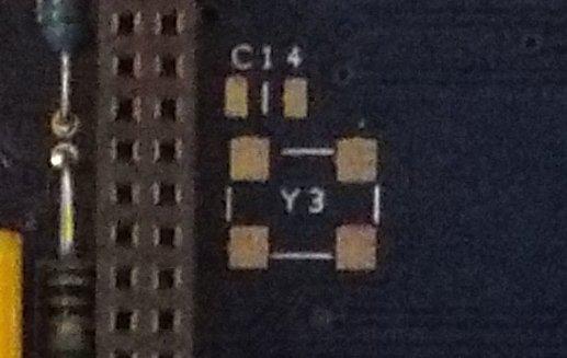

Any idea which way round the Oscillator goes?
It does not appear to be marked on the v3.0 board or included in the schematics.

You can just see the pin 1 dot in your picture - top right
Parts should be fine. Be very careful soldering the oscillator that the solder doesn't wick up onto the case.
It will probably work even if you leave the crystal in place on the Waveshare but it does kill the crystal

  matherp said  You can just see the pin 1 dot in your picture - top right
Thanks for your prompt reply Peter.
I had missed the DOT in the picture

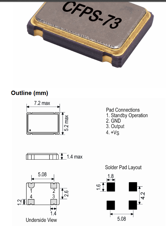

When I fitted the crystal oscillator.  Do this first!!! I tinned the pads on the pcb, used solder wick to make sure there was only the smallest amount of solder bulge on the pad, applied some liquid flux, and tacked each of the 4 corners with a hot needle point iron.  This did a neat job for me.  As mentioned previously, be very careful not to create a short with the metal lid on the oscillator.
Pin One on the oscillator is a different shaped pad on the underside of the device.
(I grabbed this from the datasheet)
Then I had a go at the "grain of rice" (capacitor).  The same technique worked, but it is not pretty or flush to the pcb.  The capacitor is not polarised and can go either way around.
A magnifying glass, tweezers to hold compnents in place and a pointy iron got the job done ... even for an amateur hobbyist like me.
