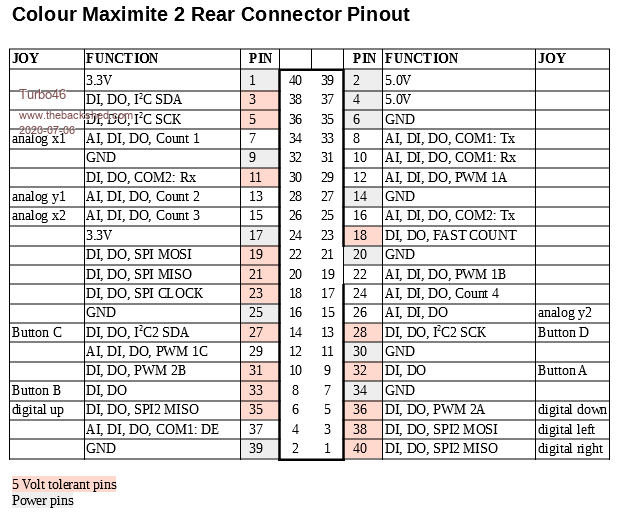

Could I please make another suggestion for joystick pin allocation?
If I am correct, it is unlikely that analogue and digital joysticks will be used in the same game? so how about using the analogue pins for one or the other to suit joystick being used:
analog x1 / digital up - pin 7
analog y1 / digital down - pin 13
analog x2 / digital left - pin 15
analog y2 / digital right - pin 26
Button A - pin 32
Button B - pin 33
Button C - pin 27
Button D - pin 28
That means that joystick with a pot(paddle?) is not catered for but it should leave enough pins for a second joystick if the need arises but that may interfere with COMs functions.

This shows the pins chosen by VegePete along with the normal functions.
