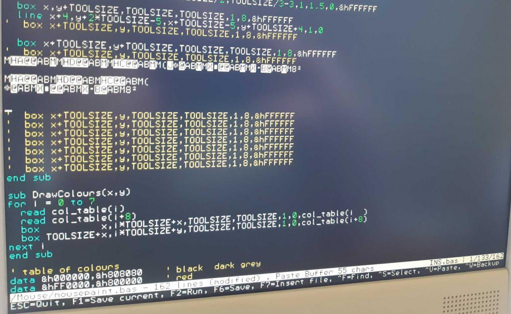

For the past while, the editor has been quite stable with no glitching associated with cutting, copying and pasting. But today I've had a few errors. (v5.0303 - release)
This time though I have a new data point. I have a mouse connected to com2 and it was the mouse position report that was pasted into the editor. Trouble is, I can't reproduce it at will.
open "com2:38400,256,MouseInt,8" as #4
The external hardware transmits 8 bytes of mouse data whenever the mouse moves, up to about 30 times a second. These 8 bytes (repeated a few times) replaced a line of text involved in a copy/paste operation.

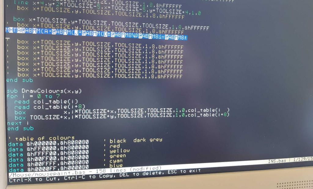

Mucking some more, I got another one. I was wiggling the mouse around (to ensure com2 traffic) while starting to copy. Here is a picture of the screen:
I had just pressed [F4] and arrow down once. The line selected was exactly the same as the line one above the gibberish line. There is one space character at the end of the non-gibberish line.
Here is a second picture after pressing [F5] to copy, down arrow once, [Enter] once to make space and [F5] to paste:
The format of the string received on com2 is 'M', 4 bytes of binary data, 'A', 'B' and finally '\r'
The actual 4 bytes depend on the movement of the mouse. (Inverse '@' is 0x00, isn't it?)
Inverse 'M' in the original line is '\r' which is removed in the pasted line. Inverse 'J' appears to have been changed to "\n\r"

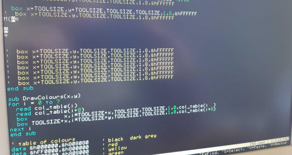

If I save with [F1] and then immediately 'edit' again, the editor now shows:
Note the above is still a rare occurrence. I cannot reproduce it at will.
Does this help in any way?
