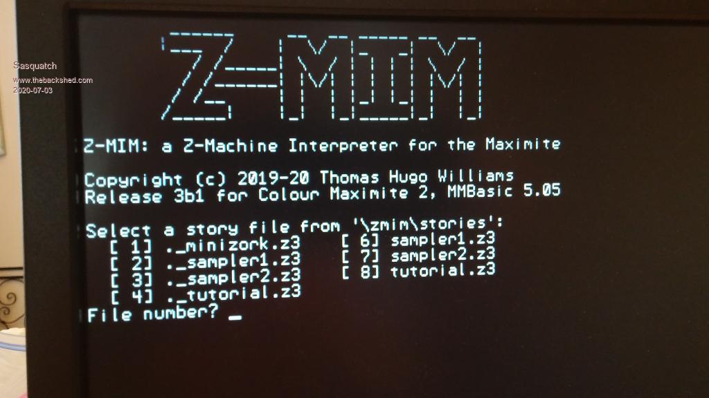

Hi Tom,
I just received my CMM2 hardware a few days ago.  I have played with your Z-MIM a bit now.  It seems responsive and works well as far as I have tested.  I had a question about the story file menu at the beginning.  On my setup options 1-4 start with ._ and the samples and tutorial are listed each with a ._ prefix.  These don't seem to work.  Option 5 is missing from the menu, but will play miniZork if selected.  Options 6-8 are the two samples and tutorial and these also seem to work.
I am running MMBasic 5.05.04b1r
Z-Mim version 3b1
I downloaded your zip file to the root of A: and unzipped it there.
Also any hints on where to download more story files?
-Carl

Hi Carl,
Thanks for taking an interest.
  Sasquatch said  On my setup options 1-4 start with ._ and the samples and tutorial are listed each with a ._ prefix.  These don't seem to work.  Option 5 is missing from the menu, but will play miniZork if selected.  Options 6-8 are the two samples and tutorial and these also seem to work.
Strange, that's not what I see and it's not like we should need to worry about having different hardware. Running a fresh "install" of Z-MIM I see only 4 options:
Could you please post a photo of what you see?
Also please run and post the output of:
ls "A:\zmim\stories"
The "zmim.pdf" included in the distribution lists stories that are legitimately downloadable from the internet. A little imagination may help you find others.

Posted: 07:13pm 02 Jul 2020
I swear, I'm not making this up!
This is what I was seeing:
Well, the mystery is solved at least partially.  Apparently my MAC created the files with the ._ prefix when it unzipped the file structure.  Not sure why the miniZork does not show up as option 5, but if you enter 5 at the prompt it does indeed play miniZork.  Also, not sure why the ._ prefixed files were created in the first place.
These files do not show up in the CMM2 file manager, but they apparently show up when ZMIM asks for the contents of the directory.  I am using an old SD card that was formatted with FAT16 so it may have something to do with long filename support on FAT16 or something like that.
Edit:  The files apparently contain "metadata" used by MAC OSX and are "hidden" files.  It's interesting that the CMM2 file manager seems to know not to show them but they are reported to ZMIM.  I'm going to try formatting for FAT32 to see if the files are still created when I unzip the archive.
Edited 2020-07-03 05:17 by Sasquatch

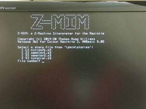

Posts: 4406
Posted: 08:43pm 02 Jul 2020
Dear Carl,
Thanks for the first Z-MIM bug report.
- The issue with the missing "minizork.z3" is a bug in my table rendering code that I've now fixed and will be in the next beta.
- For good measure I've also changed the code to ignore any files beginning "." since no legitimate .z3 will have such a prefix.
Since this isn't a critical failure I'll probably wait until the weekend to package a new version.
