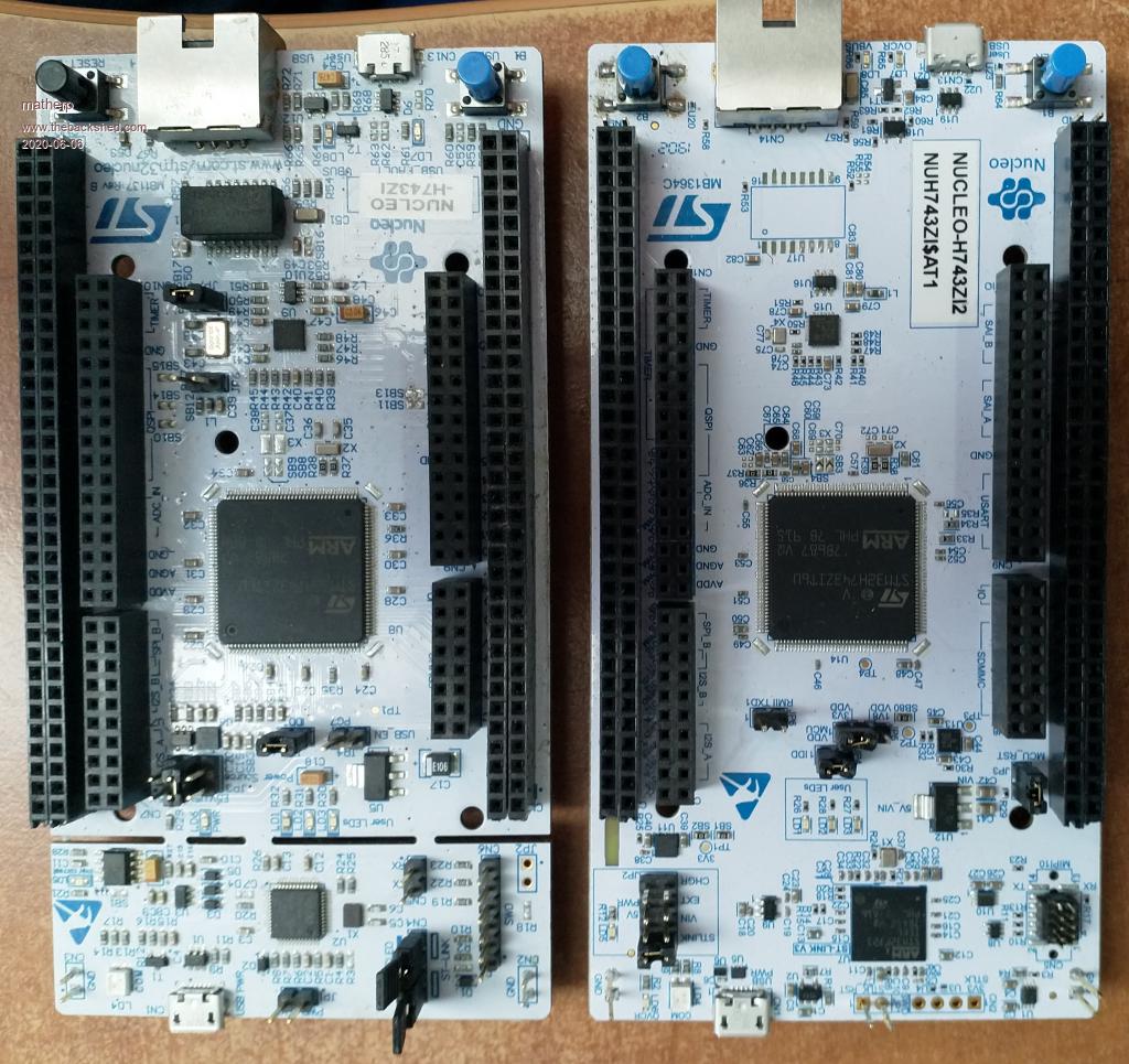

Posted: 02:24pm 05 Jun 2020
  matherp said  John
There is a version of the ArmmiteH7 code (Nucleo-H743) here that was tested with CFunctions. They have since been removed from the ArmmiteH7 code to save command slots. If you want to have a go working out how to set up STM32CubeIDE to generate something position independent then it can be tested on this version. This of course is the same chip as the CMM2. It is not something I'm going to look at for the foreseeable.
Thanks.
I've flashed my Nucleo-H743ZI (MB1137 Rev B) with it, and the flash reads back OK (so long as I don't let MMBasic run, as it looks then to overwrite part of the flash).
I've got a USB-serial device (set to 3.3V) connected to Gnd, PD8 & PD9 for the console and at 38400 baud I see the MMBasic start-up messages (V 05.04.18 etc) and the ">" prompt.
I can't input anything, nothing even echoes.
If I press RESET I get the start-up messages each time, as expected.
The USB-serial device works fine (checked by connecting its Tx to Rx & with other boards).
The Nucleo board seems OK generally (ran its test program OK before I flashed it, and its STLINK enumerates apparently OK).
Is there some magic I need to do that I've overlooked?  Maybe with jumpers?
I'm powering the board via CN1 (STLINK end of board) before powering up the USB-serial (in case it can leak power).
I expected this to be the easy bit!
Thought I'd next check the strrev in the thread works OK and go from there...
(I disassembled it out of curiosity and built a rough equivalent bearing in mind I don't have the actual source that was used.)

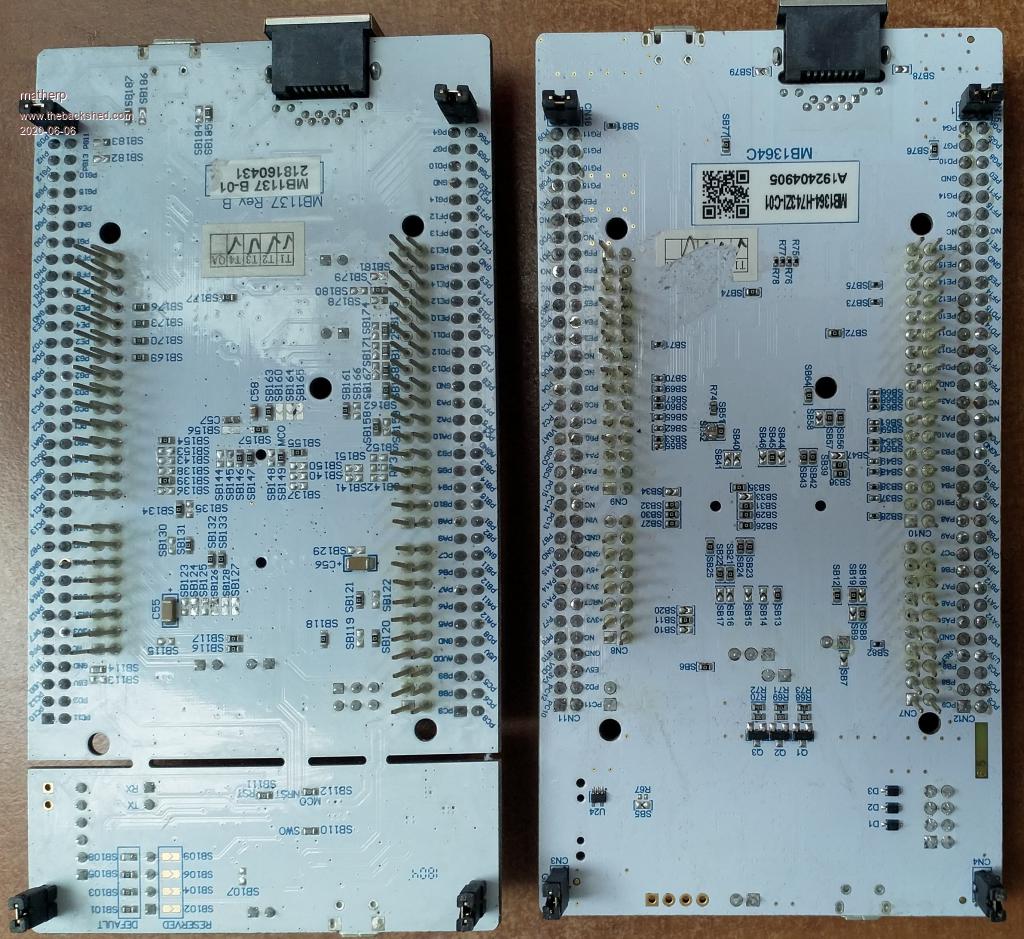

Posts: 12093
Posted: 03:03pm 05 Jun 2020
Not sure which version you mean but pics of my board attached,
 both tested with RC18, both work, both verify properly if H/W reset selected in STM32CubeProgrammer. After programming disconnect ST-LINK and press RESET.
You should be using the ST-LINK VCP as the console unless you disconnect it it will conflict with direct connection to the pins
Edited 2020-06-06 01:13 by matherp
Posted: 03:40pm 05 Jun 2020
Looks like the left one - with PCB marked MB1137 Rev B.
But for the console I've connected direct to the pins :(
Will now investigate VCP (never heard of it!).
edit: aha - got it! Can use /dev/ttyACM0
