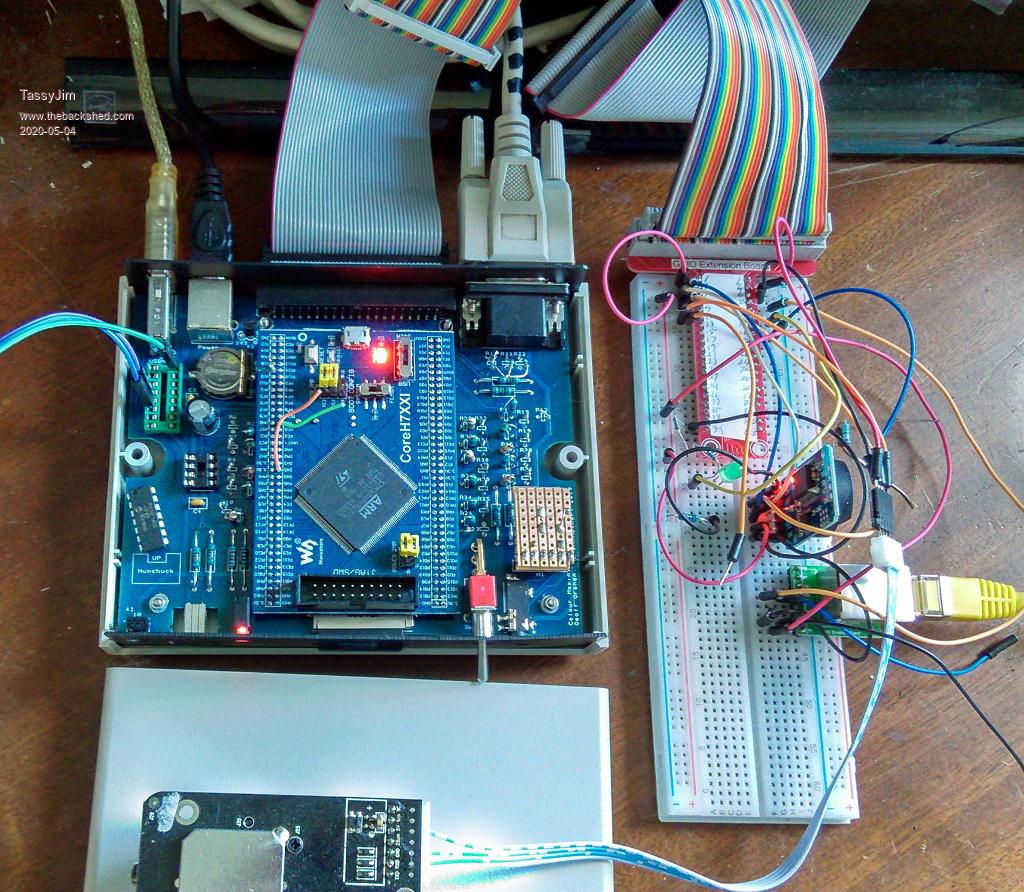

  flasherror said
Questions
1. The only way to power this is via 5V USB "B" connector - there is no separate power jack apart from USB?
2. Kind of concerned about static/ESD on Pin 40 triggering unwanted program erasure. Any hardware filtering or long debounce on this pin for the power-up erase input check?
3. Was there a reason for full size SD cards rather than microSD?
Constructive criticism
Answers
1. Correct, the USB power is it.
2. No issues so far with long 40 way cable and various breadboards connected.
3. Large is easier to solder and easier for aging fingers to handle. Adapters are sufficient for micro cards.
Constructive criticism - you gave the answer. That is not the chosen market.
Serial, I2C and SPI are all available on the 40 way connector.
There are plenty of options for controller boards that need more IO.
Geoff beat me.
Edited 2020-05-04 12:04 by TassyJim
