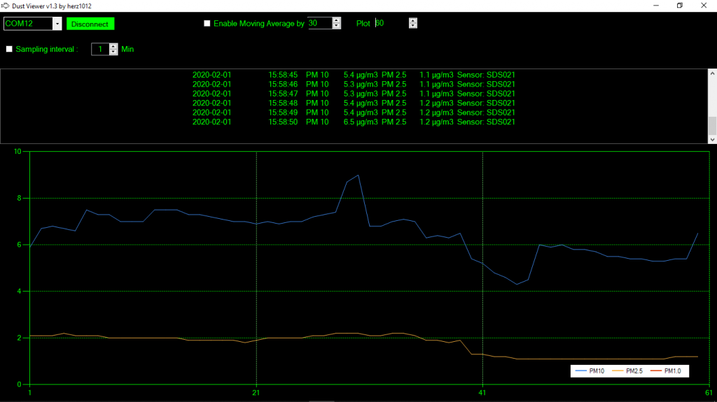

I've got the sensor running by using the supplied USB connector and some free Windows software from here.
This takes the binary data from the SDS011 and plots a graph of P10 and P2.5 readings over time (on the PC). (I've not mastered it by any means)
Now "all" I need to understand is how to dispense with the TTL to USB connector and communicate with a MM (I'll probably use another LCD Backpack).
Jim's pdf's above seem to explain it all - but are a little beyond me (particularly communicating via serial in hex (I'm used to ASCII strings)).
(any tips welcome . . .)
