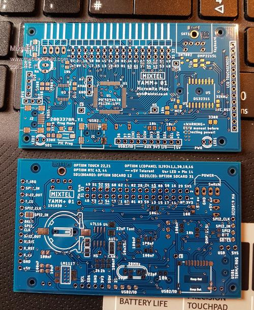

Well, the PCBs have turned up at last!
You know when you make a mistake it should always be a big one? This one is a beaut! I've only gone & put the microSD socket on wrong way round...
Oh well, the touch display SD socket should still be fine so these boards should be ok with that limitation. We'll see when I manage to get one built up.

Things are moving on. Slowly. Still collecting parts to build up the first of the YAMM+ 01 boards. I've not been wasting time though, having built a vacuum pick-up tool and done a little more SMD soldering practice.
I mentioned a second PCB at the beginning of the month. Well, I have a sort of design for one now. It's intended as a local IO board for small industrial control. Tentative name is YAMM+ 02, as it's basically part of the same system. A lot of this is still in the "ideas" stage when it comes to software, especially the watchdog function. That would be written in GCBasic as I'm proposing an 8-pin PIC to save on board space.
* Powered from 24VDC. Contains regulation down to 5VDC. Gets 3.3VDC from the ribbon.
* Connects to YAMM+ 01 via a 30-way ribbon (It appears that 16+16-way plugs are like unicorn poo to get hold of).
* 5off 240VAC rated output relays (powered at 24V), 4 SPNO, 1 SPCO. All can be monitored using a nc second contact (used internally - not wired out).
* 2off 24VDC opto-isolated, unfiltered PWM outputs. Can also be used as active high DC outputs.
* 8off 24VDC opto-isolated digital inputs with LED indication. Split into 2 banks of 4, each bank can be wired active high or active low. By changing input resistors they could be different voltages too - just to confuse people. :)
* PIC Watchdog, using a single pulsed-low bi-directional line in the ribbon. Mosfet to disconnect all relay supplies on watchdog fault.
* Watchdog chip also monitors 24VDC supply voltage.
* Opto-isolated 24VDC "High" output on healthy signal from watchdog. LED indication of "Healthy" status.
* SPI is available on 5-pin header with +5V and GND.
* RS-485 is available on 6-pin header. A link on the header enables 120R terminator.
* ICSP header for playing with the watchdog software.
* PCB size fits standard DIN rail modular mounts from OKW. I've also pushed the size almost to the limit for the free version of Eagle at 7920sq mm. :)
There may still be problems. I'm not sure what current the YAMM+ 01 will draw yet, so the heatsinks on the regulators may be too small. (Pre-reg down to 15V then reg down to 5V. Not enough space for a switcher. :( ). It will have to feed the 2.8" TFT display as I've used the other IO pins. lol
The SPNO contacts are because of electrical clearance problems with the NC contact. I could make all the relays SPCO at 30VDC max.
I'd like to have included some analogue inputs but I ran out of space and IO pins. That might be for YAMM+ 03, which would probably plug into the SPI and sit alongside this module. :)
The schematic and PCB design is more or less done now. I'll probably tweak a few things yet.

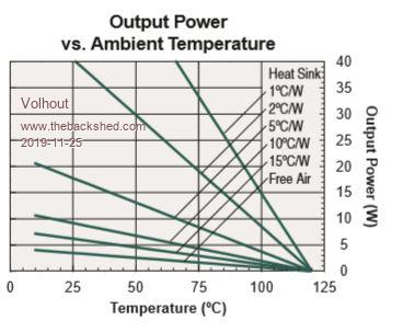

The question about using the CPC1998 directly driven from a microcontroller and what heatsink can only be answered if you specify the operating temperature range at location where the CPC1998 is located.
The part can operate from -40C to +85C but parameters change with temperature.
If you can drive the LED with 5mA or more you should be fine, but for 10 that is 10 x 5mA directly from microcontroller IO pins.
Then the heatsink: the specified voltage across the CPC1998 is roughly 1V at current around 1A. The 125W/110Vac pump would therefore cause a dissipation of roughly 1.25 watt in the CPC1998. With sufficient air flow that could work without a heatsink at room temperature.
But if your pump should work at 55 degrees C, with 10 of these switches in a little box, each dissipating 1.25watt, the temperature inside the box could be well of 100 degrees C.
Total dissipation of the 10 switches, if all on, is around 10 watt.
With a small fan that could be done without heatsinking. just place these switched 1/2" appart in a row, and let the fan flow some air between the CPC's.
If silence is required, you may have to revert to an ALU block like old audio amplifiers use.

Mixtel90 is right. But please understand that 10 of these CPC's may generate a lot of heat. 16 watt requires a big box with ventilation slots, just to get rid of the heat when ambient temperatures rise to 40C on a summer day.

Hmmm... I should have thought of the combined heat output really. I don't know what the ambient is either or how many of what size pumps will run at the same time or how close together the CPCs would be mounted. All these have an effect.
