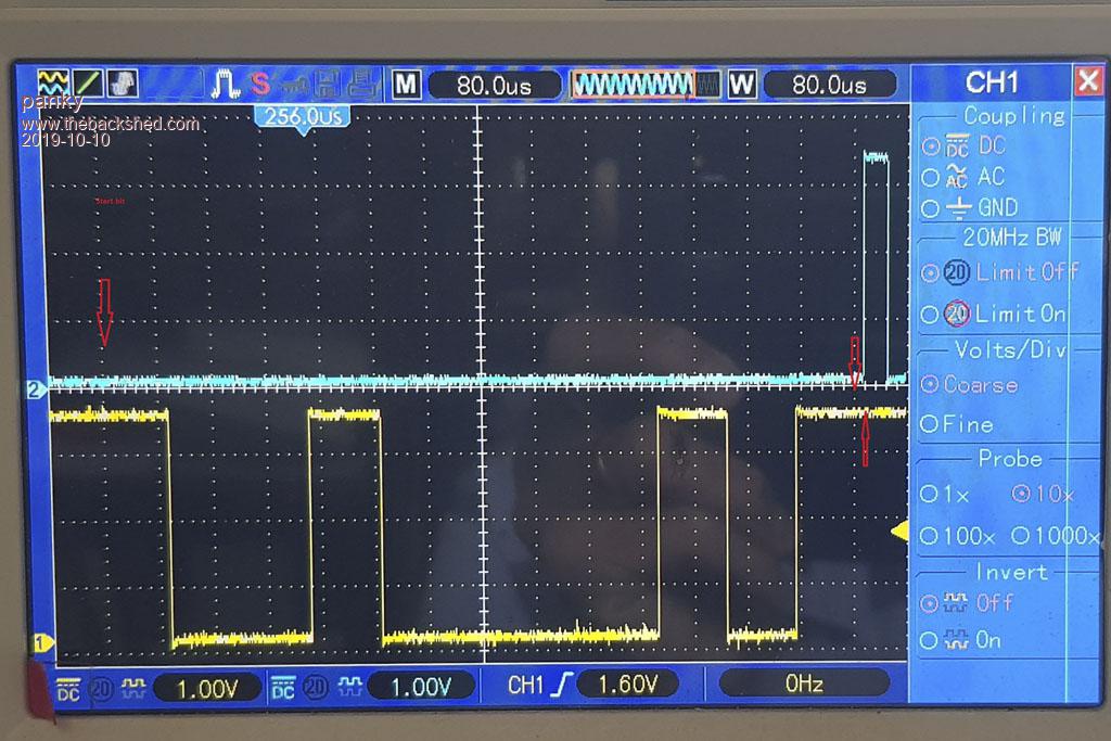

Regarding the interrupt timing, I ran the following code on a 170 and fed characters into it from a terminal.
The delay between the end of the stop bit and the Rx interrupt service routine activity starting was around 80uS - it varied a little by 5uS or so and this is because there is no way of determining EXACTLY where in the do/loop sequence the interrupt occurs.
This is exactly in line with what you would expect as each MMBasic line interpretted takes on average 30uS so the jump to the interrupt service routine then get the character with INPUT then pulse the pin ~ jump time + 30uS + 30us.
If you omit the INPUT statement, the lag is less than 10uS between the end of the stop bit in the received character and the leading edge of the pulse
This is absolutely repeatable so any delays in servicing an interrupt are solely due to what other activities the 170/MMBasic is trying to do at the time the interrupt occurs.
Looking at the interrupt priority order, only higher priorities will break into the processing of the COM interrupt service routine.

panky
goc30
Joined: 12/04/2017
Location: France
Posts: 435
Posted: 02:24am 10 Oct 2019
Hi Panky
very good job! thanks!
