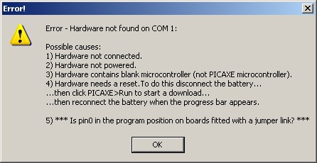

Before you said you were getting this error message
Or has it changed to this one which is what I'm getting now and I can't track it down? My chip is perfect in a different board.
If your having same error I'm looking for the common component at fault.

the first error is the main one i get, i did get the 2nd one once, when i connected to my sons computer, I could see firmware ok, then i got the 2nd error then i tried to program the chip and got the 1st error.
even with the LED test which removes most components i get the 1st error, i checked LED polarity and the resistors b4 assembly.

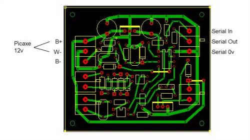

Gill
Joined: 11/11/2006
Posts: 669
Posted: 06:07am 13 Aug 2008
Gordon,
I seem to have it licked now. As you say, serial or power was what I concluded too. The official Picaxe Forum has many queries on this error and none of the experts can present a sound knowledge of its cause. One of those where every man has a different opinion from varying approaches. However a reoccurring theme was bad power not so much low power. Another was change computer and change cable ( Serial to USB (not adaptor)).
Sounded a lot like recommending assassination by stabbing someone with a blindfold on.
Now I had previously bypassed the reg with 4.7v direct battery supply but because I want to be an expert too one day, I tried them all, and like them I now have 'MY Opinion'. I changed Glenn's circuit by adding 0.1uf caps to either side of the voltage reg like the recommended picaxe power supply. I used a different computer, and used a USB adaptor lead. And it worked. Download OK, Upload OK. Great!
Back to the original computer with original serial cable and all still OK. Go figure. 'MY Opinion' is that I don't know what happened and I'm still a long way from expert status. Ah well, it's still a successful outcome.
Martin,
Have sent off your board within 24 hours as promised.
When you get it back please connect up the power and serial cable and then open Programming Editor. From the toolbar, select PICAXE, then Terminal. You should immediately see the incoming data stream.
IF NOT, the problem is in your serial cable or computer settings.
Initial connection:
Of minor concern but major effect is where you connect the 12 Volt power to the terminal strip. B+ is clear as it's the top one. The middle one is W- (Windmill neg ?) and the bottom one is B - (Battery neg ?). For setup and testing connect 12 volts across the terminals you have marked B+ and W-. Your terminal B- is for your Amperage metering and is not used for powering up the Picaxe.
Glenn,
In the site code and also in the .zip download of Version 1. Logger Regulator, this line needs editing:
sertxd("[<V>", #volt, "</V><I>", #Amp, "</I><R>", #RPM, "</R><M>", Mode, "<M>]")
It needs a # in front of Mode, and a / in "<M>]"
You might like to work your magic keyboard on them when you, got a minute.
Cheers Gill _Cairns, FNQ
