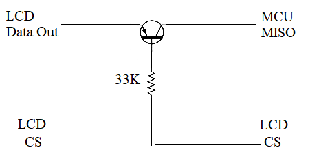

Re the panels with crook Data Out (MISO).
I managed to damage that pin on one of my ILI9341 displays by plugging it in one hole over (old eyes). Got it going with this:-
It may be worth a try on them.
The transistor is a PN200
PS Not only does it restore normal operation of touch and SD card but IMAGE SAVE and BLIT READ are working also, so the pin is working as an output it just can't switch off.
Edited 2022-01-08 21:22 by phil99
Posted: 01:18pm 08 Jan 2022
  phil99 said  PS Not only does it restore normal operation of touch and SD card but IMAGE SAVE and BLIT READ are working also, so the pin is working as an output it just can't switch off.
Sorry but my understanding of the magic that BJT transistors perform is shaky. When you say, "it just can't switch off", what are the consequences of this?
Is this a solution to the ILI9488 MISO problem--gating the MISO pin with CS? In other words, would this prevent the over-talkative MISO pin on the ILI9488 from interfering with an SD module?
Posts: 3418
Posted: 09:15pm 08 Jan 2022
"Is this a solution to the ILI9488 MISO problem--gating the MISO pin with CS? "
I am suggesting it could be. I don't have one to test. The ILI9341 that I damaged was displaying the same issues as the ILI9488 so it is well worth someone trying it. The transistor imitates cutting the pin except when LCD-CS is low, so touch and SD work normally. If the problem with the ILI9488 is that the pin is simply short circuit rather than permanently active, as is the case on mine then it won't fix BLIT or SAVE IMAGE.
Turbo46
Joined: 24/12/2017
Posts: 1694
Posted: 01:55am 09 Jan 2022
phil99"s solution is another that could well work. The only issue is that it only enables the DATA OUT pin to pull the line high when CS is low, when DATA OUT is low it is not actively pulling the line low. A pull down resistor (to 0v) on the transistor collector would help.
Strange that Peter doesn't seem to want to comment on the use of a series resistor when it was he that found it to work?
Posts: 3418
Posted: 04:14am 09 Jan 2022
" it only enables the DATA OUT pin to pull the line high when CS is low, when DATA OUT is low it is not actively pulling the line low. A pull down resistor (to 0v) on the transistor collector would help."
I think mine works without the pull down resistor because the emitter can act as a collector and vice versa, with much reduced gain. The reverse beta is typically around 1/10 of forward. This only works at low voltages as the B-E reverse breakdown voltage is only 6 to 8V.
If you do use a pulldown resistor perhaps it could go to LCD-CS instead of 0V. Tried it on mine and it works as before.

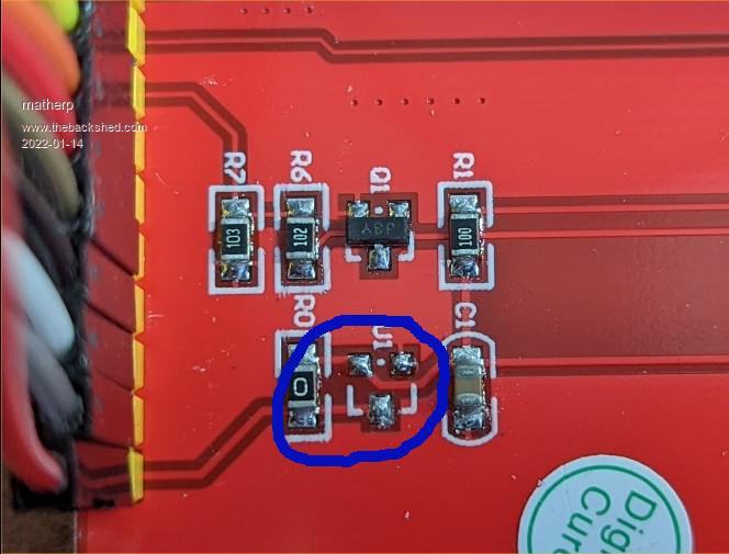

Posted: 10:45am 14 Jan 2022
UPDATE
Can confirm both touch and SDcard working with a 680ohm resistor in the MISO line from the LCD. LCD then also works with BLIT, PIXEL() and transparent text.
CAUTION the display I just purchased doesn't have a 3.3V regulator on the VDD input so if I was to put 5V on that pin then the SDcard would also get 5V -BAD!!!
