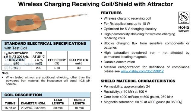

It is all explained in the data sheet for
VISHAY IWAS-4832FF-50
You young blokes never listen

Seems my guess was correct - it is a shield to protect the inductive coupling used in the wireless charging concept, from affecting nearby electronics.
This one also has an 'Attractor' - a little bit of iron in the middle of the coil to help the coupling.
Therefore, I expect the little black pad things go on top of the coil, with the coil sitting on the charger base, to stop any radiated magnetic field perhaps annoying nearby electronics. That would seem to be the situation.

The little shields DO make a big difference to the charging current.
Without it, charger current is 230mA or so, with the little shield placed on top of the charging coil - which is on the charger pad - the current jumps up to around 520mA or so. This is using a 5v @ 2A USB plug-pack/wall-wart thing.

palcal & grogster opened their eagerly awaited new toys and were mystified when a strange lump of an unknown stuff fell out. The data sheet gives enough information to indicate what it is all about.

I think your "little ferrite sticker" is probably meant as extra shielding between the receive coil and other electronics. Looking at the waveform does indicate a lot of noise.

@PeterB I agree with you - it is effective enough as a shield to stop the inductive coupling completely - i.e. when placed between the two coils, no (appreciable) energy transfer occurs, so yep I think you are spot on. Just didn't expect it to "steal" 20% of the transferred energy when simply close to it.
