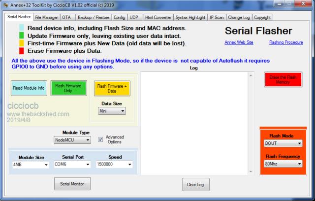

Probably your module works only in DOUT mode and your incorrect parameter (-fm gave) simply push esptool with the default flash mode (that is DOUT in annex.bin).
You can simply use the utility, check "advanced options" and select DOUT.
Then you'll be able to flash the module including the data.

hello ciccocb, yes it is working! thanks!Edited by CYBERLAB 2019-04-09

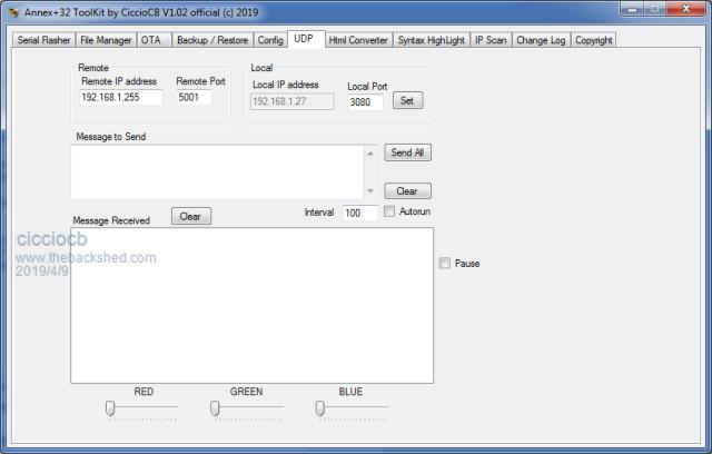

There is a little example in the documentation on how use the UDP here :
UDP event
In addition the AnnexToolkit contains a page dedicated to the development of the UDP:
