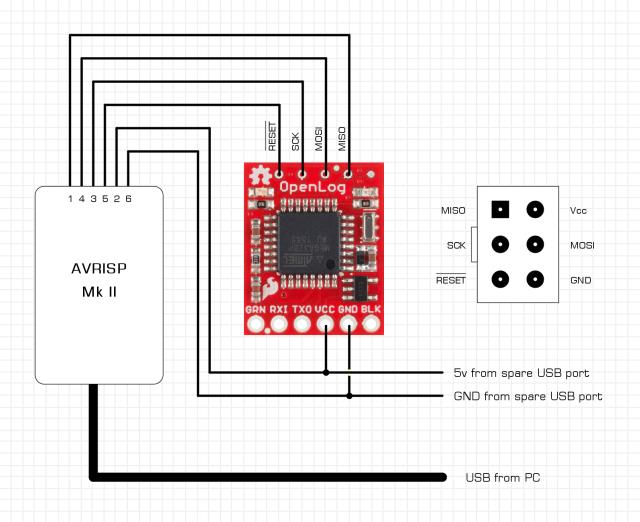

i've order a couple of the cheap programmers from ebay:
https://www.ebay.com/itm/263425223937
and
https://www.ebay.com/itm/322768772090
my money is on the arduino shield one working better :-) i already have a uno here to attach it to.
however, so far i've been using a genuine atmel AVRISP mk2, wired up to the OpenLog thus:
things to note:
1.you need to attach wires to the four vias above the word "OpenLog". on the units i have this was a bit of a challenge as there was silkscreen running right up to the edges of the holes. indeed, this may be why they were delivered unprogrammed; they may have been reject units.
2. 5v must be supplied to the OpenLog seperately and also fed back into the AVRISP. the Vcc pin on the cable to the AVRISP is an input only. it looks like other programmers can be jumpered to supply 5v directly to the target.
3. the AVRISP requires installing libusb0.1 drivers, obtainable from here:
https://sourceforge.net/projects/libusb-win32/files/libusb-win32-releases/1.2.6.0/
do NOT attempt to use any drivers supplied by atmel, they will not work with avrdude - avrdude is used by the arduino IDE to talk to atmel devices.

once you have the IDE up and running, you need to connect the OpenLog board as outlined above, then from the Tools menu select:
1. your programmer (AVRISP mk2 in my case),
2. the target type (use Arduino UNO for the OpenLog),
3. (possibly???) the comm port your programmer is attached to,
4. then lastly select Burn Bootloader.
all going well, you should get a happy message in the status area at the bottom of the window telling you everything has gone as planned (yeah, right!)
with the bootloader in place, you can now disconnect your OpenLog from the AVRISP and complete everything else using a USB to serial bridge attached to the OpenLog's 6-pin connector. the OpenLog will operate off 5v USB power directly (it has an onboard 3v3 regulator), and in addition requires RxD, TxD, and RTS. I'm using a CP2102 bridge that has RTS broken out on an extra header. this needs to be connected to the pad marked "GRN" on the OpenLog.
the first thing you want to do now is select Files -> Examples -> 01.Basics -> Blink. adjust to the correct comm port under Tools -> Port, then click on the button just below the word Edit that has a blue right-arrow on it. this will (in theory) compile the 'blink' program and upload it to the OpenLog - once finished the blue LED on the OpenLog will start blinking, 1/2 second on, 1/2 second off.
congratulations, by some miracle you have got here. tomorrow evening i'll detail building the OpenLog firmware .hex file.
rob :-)
