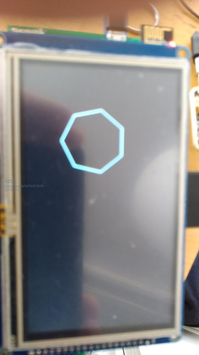

Posted: 03:09pm 14 Mar 2019
On an Armmite H7 with 4.3" SSD1963, this
[code]
> list
Option default float
CLS
CPU 100
X0 = 100 'x start
Y0 = 100 'Y start
N = 7'number of sides
L = 50'length of side
For I = 0 To (N-1)
XN = X0 + L * Cos(I * 6.28/N)
YN = Y0 + L * Sin(I * 6.28/N)
Line X0,Y0,XN,YN
X0 = XN
Y0 = YN
Next I
[/code]
produces this:
The camera (out of focus, sorry) picks up the lines as much fatter than they show on the screen.
Edited by lizby 2019-03-16

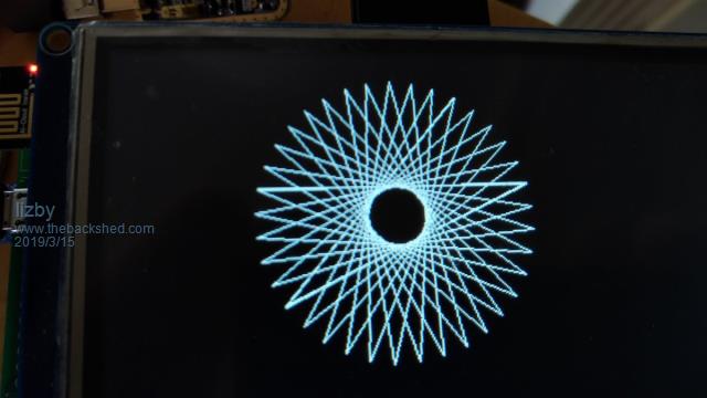

Posted: 06:34pm 14 Mar 2019
Ok. Like this:
[code]
> list
CLS
CPU 100
X0 = 100 'x start
Y0 = 100 'Y start
N = 40 'number of sides
L = 200 'length of side
For I = 0 To (N-1)
XN = X0 + L * Cos(I * 360/N)
YN = Y0 + L * Sin(I * 360/N)
Line X0,Y0,XN,YN
X0 = XN
Y0 = YN
Next I
[/code]

Posted: 09:57pm 14 Mar 2019
I hope that is what max wanted.
It could be tidied up by making both 6.28s, Q x 6.28 where Q is the number of laps.
Changing L, N, Q would give a big range of shapes.
It is now 8:30 am. I went back to bed
