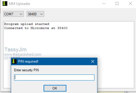

The PIN was more of a pain than I expected. It is very slow to respond (deliberately to stop brute force attacks)
I can change the PIN dialog to a 'password' type which hides the entered digits.
You only get one attempt at the PIN.
There is a bit of information there to help tech support.

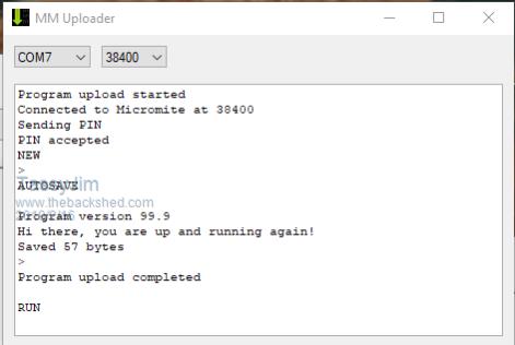

  Quote   OPTION PIN 9999
'echo Program version 99.9
DO
FOR n = 1 TO 20
PRINT n
NEXT n
LOOP
'echo Hi there, you are up and running again!
The two 'echo lines are sent to the text window instead of the micromite.
I will speed up the upload using Rob's method eventually.
For now, I need some heavy destruction testing.

I have been experimenting with the command option
'onload command
OPTION LCDPANEL ILI9341, RL, 4,5,6
OPTION TOUCH 7,2
GUI CALIBRATE
This configures a module I have, something that has to be done after firmware updates.
The extra blank lines were needed to give the micromite time to reboot when the display is configured.
GUI CALIBRATE has to be the last command because it take time while you do the calibration.
I intend to have one BAS file with all the different setups I have for the various devices. It is then a case of highlight the one I want and drop it into the uploader.
As it stands, MMUploader disconnects as soon as the RUN command is sent.
I am thinking of waiting a few seconds after RUN before disconnecting. That way any immediate messages from the micromite will be captured by MMUploader.
It might be useful as a way of confirming the program is running (or capturing any error messages).

This is working very nicely!!!! I love the com port detection, what a GREAT feature for a non-tech person. Nicely done.
'encode
'encode crunch
'onload crunch
'onload crunch settime
all work flawlessly.
Will test the RTC when new module arrives, mine seems to have died.
This turning out to be a brilliant utility. Your command options are a great idea also.
