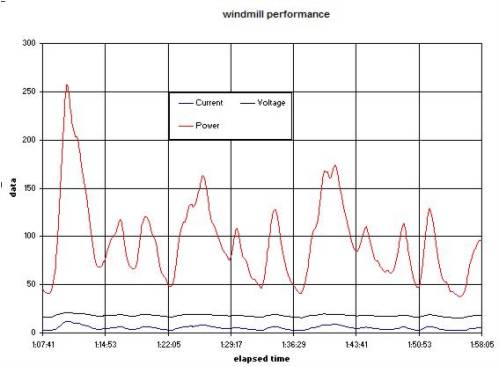

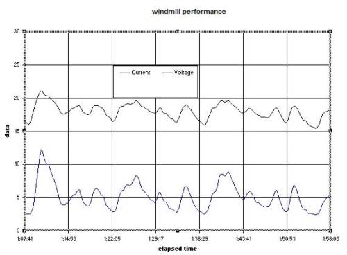

Hi readers,
I have posted a graph showing real time Maximizing, and the response time that needs to be achieved, to capture the energy in a gust of wind.
Between 1:08:00 and 1:13:00 on the graph, the maximizer had to follow a wind gust. This was a transient from 45W to 250W and back down again, in a 5 second window.
This cannot be achieved with the MPPT example provided in the link presented in a posting above.
I have scale expanded the windmill voltage and current for the same time period and graphed it. The upper graph is the voltage and the lower is the current.
This power is charging my 24V battery, whenever the current is greater than zero. The battery was at 27.6V, so you can see how much of a range of voltage and current that has to be converted to a current and voltage the battery needs. The battery voltage [not shown] was being held relatively constant by the gridfeed cct that supplements the base load of my house.
I have struck a few glitches in the picaxe code I am developing for the O8M chip. The code did not correctly load the windmill at power levels above 150W. I could not test this level on the laboratory power supply I use. I am working on a modifier to correct this. At the same time the code has to compensate for different battery state of charge voltages as well. I have to write 2nd and 3rd Order Poloynomial modifiers, that I will still have to test.
As Oztules has said, an idea can seem to work on a simulator or test rig, but until the real world windmill experimental test is proven, you may have nothing. .. .. Gordon.

I still have to test my lastest code revision on my windmill. Wind was a bit scarce today.
I have compared the loading curve for a buck design, and it is much easier than the boost to track. This is probably why this is a good system type for developers to look into. The boost design has an inverse control relationship, while the buck is a proportional type. The SEPIC is supposed to be more complicated.
Re:
Gordon: Re gusts and the PIC following with error signals. Isn't this just a case of sampling more frequently with a faster PIC?
In my control system, I do not refer to an error signal. This is jargon used with a system that performs a regulation function. My current system relies on a single digitally averaged measured variable. This is a "direct" control system. All I need to know is the minimum desired cutin generator voltage and the nominal battery voltage and the maximum expected windmill power. I have developed a spreadsheet that formulates a loading curve, and this is programmed to the picaxe. I have adapted the spreadsheet to formulate for a buck system as well. If I had a 20A@50V variable laboratory power supply, I could test without a windmill.
The PCB I have made is a good layout for the boost design, so I will look at a new layout for a buck design.
A windmill is not really a complicated machine. I see a few variables, that I do not measure, that will change windmill blade performance, one is air viscosity, and another is blade wear. These will change the efficiency of the blades and hence available wind power. I will ignore these for the moment. I have deliberately avoided the term MPPT, I rely on the windmill inherant predictable features and maximize from that.
I have also lowered the minimum windmill cutin voltage from 8V down to 6V. This may not seem much, but this will probably be a good point for my F&P machine.

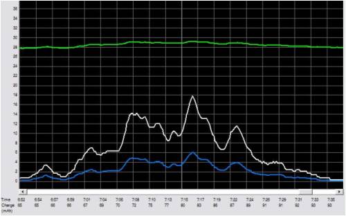

I have completely redone my picaxe code and now have adopted pulse frequency modulated, pulse width modulation. This has exploited a design property of the picaxe micro interpreter, when used to produce a PWM output.
The latest revision has allowed the generator cutin voltage to be dropped a further 1V, to 5V. This has meant that my data logger cannot be inserted between the mill and maximizer, but has to measure the battery voltage and current after the maximizer.
This graph is a typical output from a wind gust with the new code.
the green line is Battery volts
the white line is windmill power [x10]
the blue line is Battery charging current
the maximum power occured at a windmill current of 11A and a windmill voltage of 17V. The lowest power was 1W at a windmill voltage of 5V and 0.2A This gust would not have been captured if the windmill was directly connected to the battery, ie, without the maximizer.
The gust occurred over a 30 second time window. There were at least 4 separate mini gusts components, and I can see no oscillitory behaviour of the control system. This is probably because there is no feedback system or error correction, or delay lags. This was sampled at 0.2second intervals.
I will have to make a new logger, that can log current and voltage from 0 to 30 at up to 100 times per second, that is not powered from the windmill. This will measure 4 parameters, windmill current and voltage and battery current and voltage, so the performance of the electronics will also be seen.
This new unit loads the windmill almost the same as my analogue unit. The cutin voltage is now 3V lower as well. I will have to wait for more stormy weather to check the top end performance.
I will publish some more test data later, as it becomes available.
I will have to look into a way of making the code universal, so it may work on a F&P, or other windmill. Once this is achieved, this will fill a windmill performance gap. .. .. Gordon.

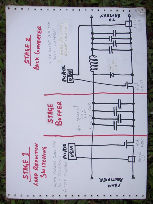

G'day all,
I don't like the idea of having to number crunch a look-up table. Besides being too heavy a load on the brain, it is not suitable for a variety of configurations of generator and prop types without again more research and heavy number crunching. Maybe OK for commercial production where hundreds of the one type are made, but stifling for DIY variety, adaptability and inventiveness.
As a flow on to my earlier thoughts, here's what it looks like as it comes together. But first,
NOTE:
I must stress, for this system the mill must be designed to be underpowered until its peak (just before furling). It does not suit retro-fitting to existing mills without prior blade adjustment (shorter blades with reduced blade angle for higher TSR).
The MPPT is a 2 stage type. Each stage carries out a distinct and separate function. In both cases amps are monitored and the Pulse Width adjusted to peak the amps. This tracking and adjustment to peak with an ever changing wind, makes this MPPT suitable for any machine (see Note above) and does not require look-up tables that is individualised and a substitute for a missing first stage.
Stage 1.
The function of this stage is to cause the shaft power to track the wind power instead of the velocity as it does on our setups now. Whilst achieved by the variable pitch prop which adjusts the pitch to a coarser angle (lower TSR) to avoid stall, and so by prop gearing, match the fixed wind power to the fixed gen load. This method allows the fixed wind power through a fixed pitch prop to match the varied load of the generator. With the wind power matched to our gen(load) power at peak rpm. Most lesser rpm has the generator load power more than the corresponding wind power because of the fixed prop with it's fixed TSR. By reducing generator load the mismatch is eliminated. The gen loading at any rpm is reduced by repeated disconnecting the battery for microseconds. This tracked point sees a peak in Amps and Volts out of the generator. Now the Volts and Amps follow the wind power instead of the wind velocity.
Stage 2.
Now that we have a generator with Volts and Amps that track the wind power, it must be applied to a load. If a resistive load like a heating element, nothing further need be done. For battery charging, after cut-in is achieved, the excess volts go to heating the stator coils and rectifier and are lost to our battery. We can recover this lost potential and convert it to even more current. Here I've used the the simplest form of Buck Converter(because I'm dumb with limited knowledge) to do this task. I imagine Solar MPPT are designed to a more sophisticated standard by the professionals. Whilst they do the same task of this second stage, Solar MPPT do not have to contend with the much higher range of voltages delivered by a wind generator. The result of buck conversion is that the Amps through the freewheeling Diode sub-circuit and the Allegro Current Sensor are higher than those of Stage 1. The monitoring of these amps by the PicAXE allow it to adjust the pulse width to a peak and ever changing value. An even better understanding of Stage 2 can be had from this ZIP.

Stage Buffer.
Due to the very important Independence of switching in each stage, the OFF state of one cannot be allowed to interfere with the ON state of the other. To ensure this is so a large storage capacity is inserted between the stages to buffer all conflicting switch states.
Code.
The code for both PicAXE are almost identical but opposites. I've chosen 20,000Hz as the Pulse frequency thinking to make components more readily accessible. Though I fancy 1,000Hz for Stage 2 as it is the desulphation frequency. A PWM code would need to be specially written as that Fq is well outside the PicAXE's PWM function. Perhaps component selection will ultimately dictate what will be finally used. Code:
2008-06-28_145454_MPPT_Stages1_&_2_v1-0.zip
So there is Wind MPPT as I see it coming together for me. I feel I have the concept right. Now all I have to do is select the right components.
