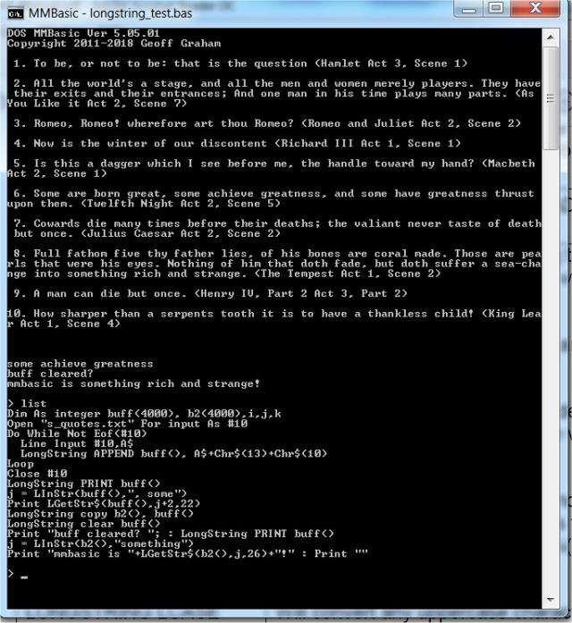

Done. Compiled in 13 seconds. Here's the output of a test program, with listing of the program.
[code]
dim as integer buff(4000), b2(4000),i,j,k
open "s_quotes.txt" for input as #10
do while not eof(#10)
line input #10,A$
LONGSTRING APPEND buff(), A$+chr$(13)+chr$(10)
loop
close #10
LONGSTRING PRINT buff()
j = LInstr(buff(),", some")
print Lgetstr$(buff(),j+2,22)
LONGSTRING copy b2(), buff()
LONGSTRING clear buff()
print "buff cleared? "; : LONGSTRING PRINT buff()
j = LInstr(b2(),"something")
print "mmbasic is "+Lgetstr$(b2(),j,26)+"!" : print ""
[/code]
Now the obvious question is: Can this be included in the beta?
