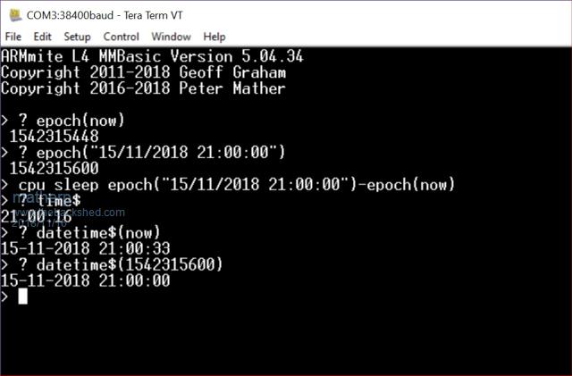

Is there a way to wake up the controller at a certain date/time (RTC)?
(After playing around with the board for a while, the RTC suddenly went wrong by a few minutes - but unfortunately can't reproduce the error...)
I also had a problem with the editor: I wanted to append a few "0" to a number whereupon the editor suddenly moved or deleted any other places in the code - leaving and calling the editor did not change anything. The code was displayed corrupted. Only a restart of the µC brought remedy - but the code was still intact...
Frank
Posts: 12084
Posted: 04:33pm 15 Nov 2018
  Quote  Is there a way to wake up the controller at a certain date/time (RTC)?
No, but perhaps I'll include it

thank you so much for your "cpu sleep epoch"!
It works very fine! Have you measured the power consumption during that time?
(I am using Tera Term as terminal program.)
