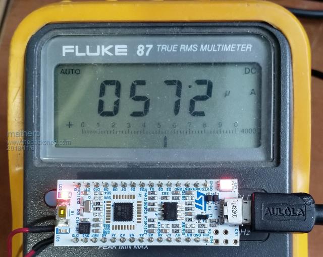

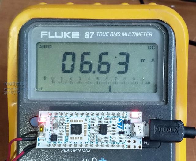

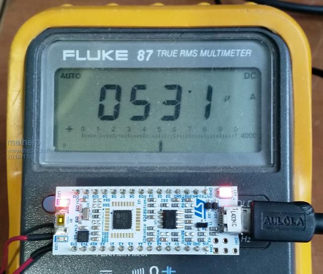

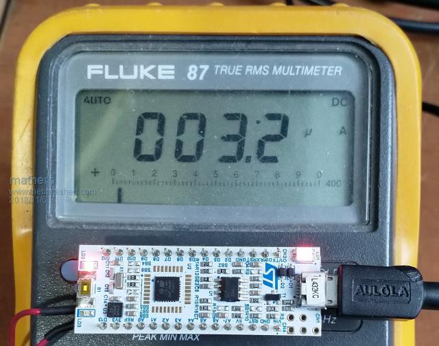

Posted: 03:22pm 05 Nov 2018
Making progress, note the last picture
Normal running at 48MHz
Paused at 48MHz (normal PAUSE command)
Normal running at 1MHz
CPU SLEEP from any speed
Edited by matherp 2018-11-07
Posts: 10081
Posted: 08:48pm 05 Nov 2018
3.2 Microamps in sleep mode - Wow....

Great work, Peter. I am eagerly awaiting a firmware release as I hope to receive some boards today. BTW how are you measuring the current draw whilst LED etc are running? Have you intercepted the supply line to the CPU?
OA47
Posts: 12084
Posted: 09:06pm 05 Nov 2018
  Quote   BTW how are you measuring the current draw whilst LED etc are running?
See Nucleo manual page 31. Measured at JP1.
