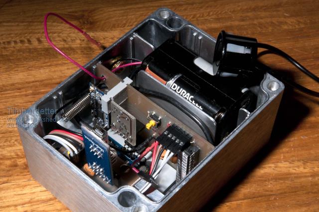

I have now got hold of the 4 components suggested by Grogster and cobbled together a prototype power supply for testing / learning purposes, using the circuit I reposted in an earlier post above. I have observed the circuit switching as expected for trigger voltages from 2 to 5 volts and mosfet source voltages from 2 to 8 volts. I am considering supplying power to the device with three AAA batteries. If I am understanding things correctly the Atmega328P should continue to operate reliably with a supply voltage down to 3.7 volts. The HC-12 would be happy at 3.7 to 5 volts. The JSN-SR04T ultrasonic sensor is specified to be nominally 5 volts supplied. I have tested this sensor with reduced voltage supply and it appears to work down to and below 3.7 volts. An alternative might be four AAA batteries with measures to lose one volt or so to the three devices.
What would the consensus be for operating the project off three AAA batteries?

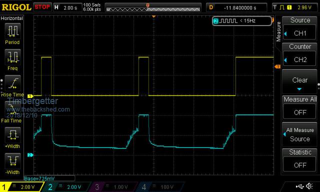

Posted: 03:58am 10 Dec 2018
My water level sensor is working as intended when the supply voltage is above about 4.55 v. The ATmega328P wakes from sleep mode sends DP5 high thereby switching on the MosFet which in turn switches on the ultrasonic sensor and the HC12 radio. After transmitting the reading the MosFet is switched off by sending DP5 low and then the ATmega328P is put into sleep mode for roughly 8 seconds (for testing sessions).
When the supply voltage falls below 4.55 v the system works for 1 or 2 or even up to 6 sleep cycles, but then goes into a state where DP5 is stuck high and the MosFet is stuck on. The attached DSO trace is illustrating this situation for a supply voltage of 4.0 v. Channel 1 (yellow) cleanly goes high for 1 second and for two sleep cycles but on the third attempt becomes stuck high. Channel 2 (blue) shows the output of the MosFet which correspondingly goes on for 2 cycles but becomes stuck on after the third attempt.
I do not understand the behaviour of the MosFet output trace which seems to indicate an oscillating ramp up to about 3.5 v ahead of DP5 going high.
Any thoughts on what might be going on here would be most welcomed.

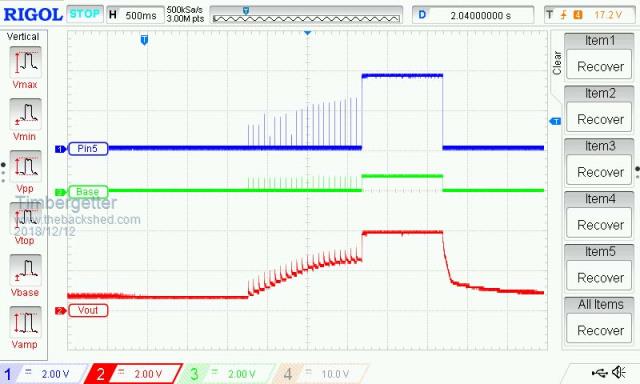

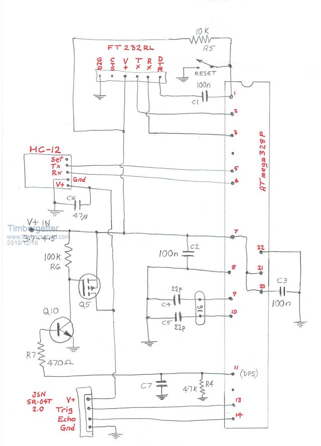

Posted: 05:23am 12 Dec 2018
I have done 2 things that seems to have improved things somewhat:
1. Made the pull-down resistor for ATmega328P’s output pin D5 more aggressive by changing value from 10k to 4.7k.
2. Reduced the R7 resistance going from pin D5 to the base of Q10 from 1000 ohms to 470 ohms. (refer to Grogster’s suggested circuit on upper part of Page 2 of this thread)
These two adjustments seem to allow the supply voltage to drop down to around 4.0 volts before the ATmega328P’s pin D5 hangs high. (It was 4.55 volts per my previous post). I was hoping to get it to continue operating down to around 3.7 volts to squeeze the best out of the 3 AA batteries, but at present the operation is unstable down there.
I am observing something on the DSO traces that I don’t understand but I suspect it might be a clue as to what’s going on. The Atmega pin D5 goes high for 1 second to carry out the waking duties. However for about 1.5 seconds prior to that pin going high there is a succession of spikes at intervals of 68 mSecs. These spikes seem to give rise to an increasing voltage for Vout (the output of the MosFet) which climbs to about 2.6 volts before switching on properly to about Vsupply. The traces below are for a Supply of 4.0 volts. When the Supply is up at 5 volts I get a similar ramping effect but not as pronounced. (it persistes for only 0.9 seconds rather than 1.5 seconds).
Does any of this make sense to anyone?

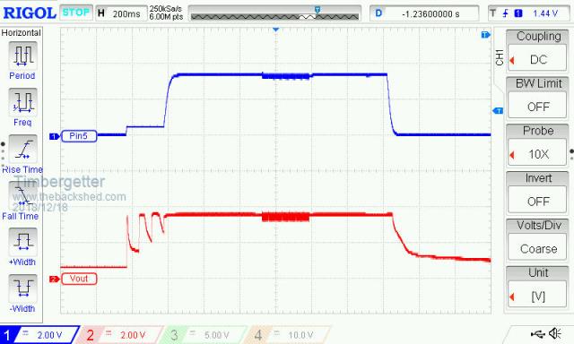

Posted: 03:00am 18 Dec 2018
I have spent some time trying to reduce the voltage spikes and instability problems that are evident in the traces in my previous post. The only thing that has quietened down the voltage spikes, which I’m guessing are implicated in the stability problems, has been to introduce a capacitor at C7 on the attached schematic sketch. It seems to me to be a bit heavy handed to be strapping a 470 µF capacitor across the digital pin Output (DP5) however it has produced a desired effect in both reducing spikes and producing stability in operation. The device has now been working without any lock-ups for several days now, even with supply voltages down to 3.7 volts. The current during sleep mode is now down to 6 µA, which will be great for battery operation.
I do suspect that the 470 µF solution is probably not desirable and may be just masking a continuing underlying problem. I would be grateful if anyone could look at my schematic and see if anything stands out as silly.
The DSO traces now show the absence of voltage spikes on DP5, although there is a brief and low intermediate step before DP5 goes fully high. The undulations on the MosFet output voltage are still there, though maybe not as severe.

Hi Timbergetter,
I don't know if it helps but your arrangement of driving the transistor Q10 seems a bit odd. You may have your reason for it, but Q10 has a collector resistor of 100k and you are driving it with 470R? I would have thought 470k would be nearer the mark, even then the transistor would only need a gain of 5. Maybe 100k to be sure with another 100k from the base to ground may be more appropriate. The 100k to ground will help ensure that the transistor does turn off fully. I'd suggest that you try that without the capacitor. The 470uF capacitor is effectively shorting the output for a while and I agree that it is not a good thing.
Timbergetter
Joined: 08/10/2018
Posts: 58
Posted: 10:05am 18 Dec 2018
Many thanks Bill for your observation and suggestion. I initially used a 1K resistor for R7 to be consistent with the schematic near top of Page 2 of this thread. At one point in my investigation I thought I observed an improvement by reducing its value. That’s the extent of my design basis. I’ll certainly give your suggestion a try-out shortly and report back.
Turbo46
Joined: 24/12/2017
Posts: 1694
Posted: 12:29pm 18 Dec 2018
Hi again Timbergetter,
I confess that I have not been following this post. Arduinos and C are not my thing but the circuit caught my attention. I have read the whole post now.
In addition to my previous suggestion, if the unexplained pulses are still there you could try a 100nF capacitor from the transistor's base to ground to filter them out. One could also be handy across the power supplies to the ultrasonic detector and the HC-12 as well - also try your 470uF capacitor across the incoming supply.
Good Luck

Posted: 09:39pm 18 Dec 2018
I have made the first changes you suggested and the pulses were no longer evident with supply voltages above 4.0 volts. When supply voltage is reduced below 3.8 volts the pulses on output pin PD5 reappear. I set it running with a 3.7 volt supply last night and it did seem to be stable (albeit with pulses) for 30 minutes, but when I checked this morning the device had hung with PD5 stuck high and the MosFet stuck on. Do you have an idea where these pulses might originate. They are very regular at either 14.7 Hz or 13.9 Hz?
I’ll try the 100 nF on the transistor’s base and see how that goes.
