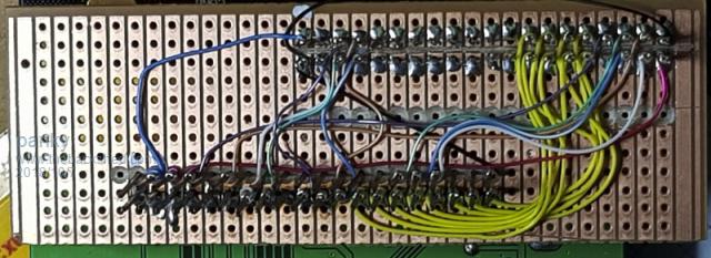

Decided to wire wrap up a little interface board and after screwing up the wiring twice, finally got that correct. Still problematic - Oh woe, don't tell me I smoked the LCL with the dodgy wiring.
Decided to put a scope onto the pins to check activity and found D5 had hardly any signal. Traced back to a dodgy solder joint on the PIC32 on pin 3. Fixed that, re-connected everything and all is up and running fine again. Whew!!!!!!
Just goes to show that when Mr. Murphy has you down, he is not afraid to put the boot in.
I guess the temp changes overnight affected the solder joint on the PIC and then I compounded that by suspecting and moving the rat's nest.
All's well that ends well!

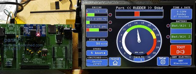

Hi Doug,
Glad you fixed it all!
With that exact 9" panel you have there, what are the viewing angles like (horizontally and vertically)? From your photo it looks like a good quality frontal image.
The 8" panels I use from BuyDisplay are really nice - I think mainly due to a good 'even' backlight illumination. I wanted to step up to the 9" panels but suspected that the image would not be quite as nice so it would be great to hear your opinion of the display quality.

Posted: 11:52am 07 Oct 2018
WW,
It looks bright and sharp at +/- 45 degrees horiz and vert. Horiz, I reckon it's still good out to 60 degrees or more.
My vision is not so good now but I can read font 2 text at about 2 metres.
This is with 5V LED power - it may be not so bright on 3V3 power - just don't know this.
Comparitively, it seems at least as bright and sharp as my 7" if not better.
At viewing distance of about half a metre, I still can't make out individual pixels (have to get really close to see them).

Posted: 05:33am 08 Oct 2018
Interesting application panky, especially with that "Toot" button. What is it, a single engine tug?
panky
Joined: 02/10/2012
Posts: 1136
Posted: 09:24am 08 Oct 2018
Canal barge in France!

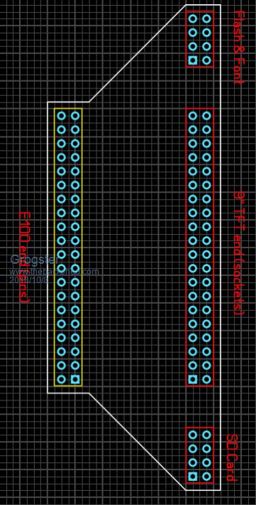

I have made a start on doing a PCB-based adaptor......
I will try to get one of the 9-inch TFT's in the next week or so, and by then I should have finished doing the adaptor.

Posts: 10081
Posted: 09:48am 08 Oct 2018
Oh, sure, I am just playing at the moment.
The references in red are just to help me when I do the actual track routing.
BTW, was this what you were thinking of?

Posts: 10081
Posted: 09:56am 08 Oct 2018
Oh, I love you too, WW....
The only think that really kept me away from using the EastRising displays, is their incompatible pin-out.
But one thing that I really like about them, is that they guarantee supply - or so they say. This means you are probably better designing with these then anything else.
Not that there seems to be any lack of the cheap displays on AliExpress or eBay....Edited by Grogster 2018-10-09

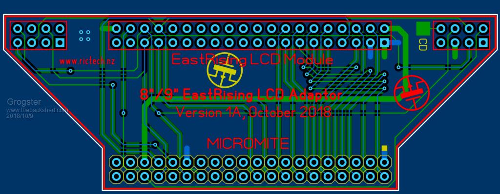

Here we are then:
If anyone sees anything obviously wrong, let me know. The board still needs a little tweak here and there on it's size and the alignment of some of the text items, so ignore those for now.
@ panky - I hope you don't think I have hijacked your idea or this thread. I did see you were going to make an adaptor, and then I saw your veroboard one, and I thought that must have been what you meant, whereas I meant a PCB version. I will discontinue posting on this thread about this board, if you would prefer.
Posted: 02:26am 09 Oct 2018
You don't seem to have data bits 8 - 15 connected.
I think that some of Peter's firmware allows for a 16 bit interface on the 8inch.
If they are not used, having them connected on the interface wouldn't matter.
The flash chip needs to be on a separate SPI interface. I think that some of the mites use a dedicated SPI for touch and SD so it could not be accessed from Basic if not separate. For the mites that do use the same SPI, it would be no problem to link them but not through the 40 pin connector. You need access to the CS pin anyway.
JimEdited by TassyJim 2018-10-10
Posts: 10081
Posted: 02:54am 09 Oct 2018
No, I have not bothered with DB8-DB15, as it is not on the E100 pinout, which is what I am basing this board on. The board is only designed to allow you to connect an E100 to the EastRising TFT. There is no allowance(at the moment), to allow it to plug into anything other then the E100, as a direct plug-in adaptor so you can put an 8" or 9" LCD module from EastRising on the E100 - just as panky did.
CS for the flash, touch and SD are remapped to the MM 40-pin header, so not sure what you mean by that last part. On an E100, the touch, SD card and flash are all on the same SPI bus from what I recall, each with it's own CS line - might be wrong, will double-check.
I do hear you on keeping the touch and SD SPI separate, so I will make changes there, and let the host board link things together as it does now. This will mean that the SD card and Flash connections will be separated as you suggest.

Posted: 03:16am 09 Oct 2018
Just thought it might be worth putting the MM+ Exp100 pin numbers and mapped function on the silkscreen somewhere (I know you mentioned you were still working on the silkscreen).
That would make it easy to know what display pin/function goes to what MM+ Exp100 pin down the track.
Posted: 03:56am 09 Oct 2018
On the Explore64 and 100, the SDcard and Touch both use SPI2.
You could wire the flash to use SPI2 as well but having the pins separate would allow users to use SPI1 instead, making life a bit easier.
SD and Touch are happy together because they are in the firmware. It's when you use Basic or a CFUNCTION to talk to the flash that timing might get tricky.
Posts: 12084
Posted: 08:26am 09 Oct 2018
  Quote  No, I have not bothered with DB8-DB15, as it is not on the E100 pinout, which is what I am basing this board on.
Please wire them, please
