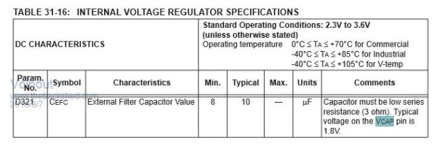

I am not sure if anyone mentioned this already, but can you check if C10 is correct?
The symptoms you mention could also be caused by stability of the core voltage regulator (internal 1.8V).
You could simply parallel another 10uF ceramic capacitor to it (not electrolytical).
The capacitor at the Vcap pin should be minimum 8uF and 3 ohm max ESR.
It is possible that due to spread in component tolerances this is critical on your board.
Ceramic capacitors typically are +/- 20%, so 8uF is within possible values of a 10uF capacitor.
If you don't have one, take the one from the second board.Edited by Volhout 2018-09-08
