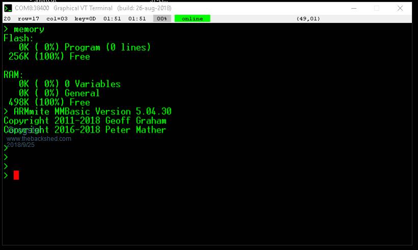

I was just playing around to make sure I was configuring ports correctly and reading pin assignments correctly. I had a short test program reading the blue user button and driving the 3 user LEDS. I made the mistake of setting option autorun on, there was absolutely no way to break out of the small test program. Had to reflash.
Now after reprogramming the chip, (verify while programming) something has changed.
Option default none
Option explicit
option autorun on
SETPIN 7,INTH,EXITINT ' user button
SetPin 137,dout ' Blue LED
SetPin 75,dout ' Red LED
SetPin 46,dout ' Green LED
Pin(46) = 1
Pause 200
Pin(137) = 1
Pause 200
Pin(75) = 1
Pause 200
Pin(46)= 0
Pause 200
Pin(137) = 0
Pause 200
Pin(75) = 0
SUB EXITINT
Pin(46)= 0
Pin(137) = 0
Pin(75) = 0
END
END SUB
If I enable autorun then the program fails on reset with an error:
SetPin 7,INTH,EXITINT
Error: Cannot find label
However if I type run, it works perfectly? surely I'm doing something stupid, can someone enlighten me (I'm not well) that's my excuse.

OPTION AUTORUN ON is normally only run at the command prompt - unless the ARM-mite is different here....
I've just tried your code, and I get the exact same error.
If I RUN the code from the console, I get three pretty LED lights.

Having autorun there was my mistake, I forgot to take it out of the listing.
Thanks for trying that - I also tried it on the MM 100 (different pins) and it works as it should. Like I said, it was just a quick play around and I didn't expect this?

From the manual
  Quote  Resetting the chip and options
The chip can be reset to “just-programmed” state by connecting pin 7 to VDD whilst resetting the chip
by grounding the RESET pin.
This should let you recover from a rouge autorun.
I expect that using pin 7 on autorun is confusing the reset code.
To test, you could put a big pause at the start of your program.
