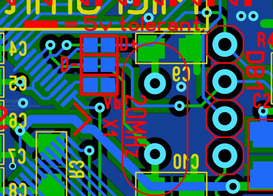

Grogs,
Could you make the board bigger and keep the same I/O pin footprint, ie route the new tracks and place components outside the existing pins or is there no room for that on your MBs.
Posted: 06:40am 21 Aug 2018
@palcal
PCB cost would be higher.
Daughter-board also allows the 'MicroBridge' power requirements (albeit small) to be removed after all design work is done (i.e. for an 'end-solution' a few mAs are saved).
Any existing solution (in which there is limited space), can have an E64 swapped out with the new design.
Posts: 10081
Posted: 07:04am 21 Aug 2018
@ Paul - no room for that. It would look kinda odd/ugly anyway.
@ WW - Same thing could potentially happen with the E28 module or the latest E100 board too. Best to simply leave the console enabled at all times. Recovery would be by reflashing the firmware, as you point out. I will make the old USB pads a bit bigger and leave them on the new layout. They might prove useful at some point to someone - who knows.

Grogster, if you can wriggle 2 more 0.1" pins next to (0.1" away) the D+/D- you have going to the daughter board and route the chip USB pins to those then you could add a 2 pin header and if needed put in 2 jumper blocks between those and the daughter board connections (with the daughter board removed while using the USB port for data). Would allow for no daughter board operation or emergency recovery without having to reflash firmware.
Something like this (excuse the bad drawing)
Edited by Azure 2018-08-22
Posts: 10081
Posted: 07:11am 21 Aug 2018
Nice idea, Azure, but no room(crystal is in the way). Board is pretty tight now.
EDIT: I will have a look and see though, as that is a very nice idea.Edited by Grogster 2018-08-22

I have seen what you can do... there is mils' in there to spare
It could be on the inside of the daughter board connector as I drew, since the header with socket of the daughter board would clear it.Edited by Azure 2018-08-22

@Azure,
Nice thinking, but I believe you would need Vusb jumper too. This then 'feels' like too many jumpers to set for a 'novice user' i.e. looks 'scary'.

Thinking out loud here, but can't VUSB be always connected, it would be if you were running just a USB power cable with no data wouldn't it?
Posts: 10081
Posted: 07:21am 21 Aug 2018
Interesting idea, Azure. Your thoughts WW?
Posted: 07:23am 21 Aug 2018
  Azure said   Thinking out loud here, but can't VUSB be always connected, it would be if you were running just a USB power cable with no data wouldn't it?
I was wondering that too - just purely to minimise quantity of 'jumpers'. In theory it will work; just not sure at the moment as to what are the disadvantages (if any).

Another thought:
What if you reverse things a bit and have D+ and D- always connected and only Jumper Vusb??
Posted: 07:31am 21 Aug 2018
  WhiteWizzard said   Another thought:
That would have two USB connections in parallel. I wouldn't like to see that.
Posted: 07:35am 21 Aug 2018
But wouldn't the Vusb act like a 'Chip-Select' for the MM PIC and hence the D+ and D- be ignored?
I am tempted to try it out just to see what happens but I am meant to be getting ready to go out (but this thread is very interesting ). The Boss will tell me off soon so I may suddenly 'disappear'!!
Posts: 12084
  Quote  Think Geoff or Peter need to confirm any disadvantages in Vusb being tied high all the time!
Slows down processing slightly as MMBasic only checks for USB input if VUSB high
Posts: 10081
Neither would I.
This is what I have so far:
I have not yet routed Vbus, and it's gonna be tight. I would love to be able to omit that one, and connect it permanently. We just need to know if that is OK to do or not.
Posted: 07:37am 21 Aug 2018
  matherp said  Slows down processing slightly as MMBasic only checks for USB input if VUSB high
Thanks Peter. Is it significant to worry about, or do you think tying Vusb high will have a negligible affect only?
Posts: 12084
Posted: 07:46am 21 Aug 2018
  Quote  Is it significant to worry about
Yes - no reason to give away performance
