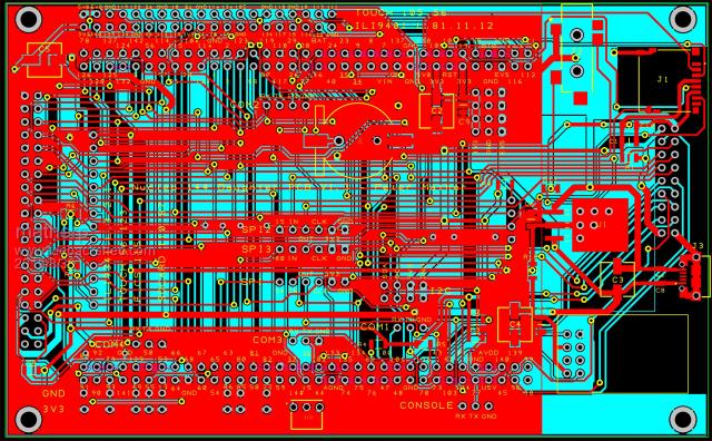

Final version
I've added an optional crystal on the bottom and a header for the console. This allows the Nucleo to be used without the ST-LINK connected (or even attached)
2018-08-30_214919_stm32h7V1.3.zip
I've ordered 5 from JLCPCB. USD27 for 137x85 PCBs INCLUDING DHL shipping
Their website is also excellent. The gerbers can be visualised online as soon as you have uploaded them before you complete the order process.

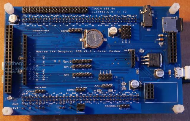

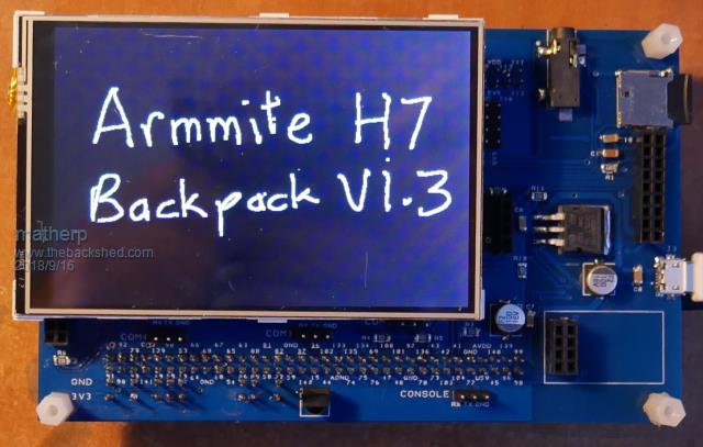

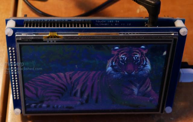

Posts: 12085
Posted: 06:36pm 15 Sep 2018
Here are the latest version of the backpack gerbers
2018-09-16_042411_stm32h7V1.3.zip
This version allows a 5" SSD1963 display to be mounted with supports. It also includes a Pi compatible header supporting any of the Pi "HATS", an IR receiver, and optional pullups on 8 of the I/O pins for things like DS18B20 as well as the V1.2 connections (ESP8266, OV7670 camera, SSD1963, ILI9341, 4*Com, 3*SPI, I2C, SDcard, Battery for RTC, Audio jack).
In addition it includes a console port and an optional 8MHz oscillator allowing the Nucleo to be used with the STlink removed if required.
The version pictured has a silkscreen error (touch connections for the Pi header should be 112,56 ), also the spacing of the 3.3V pins under COM4 should be 0.1" under the ground pins but are actually 0.125" but the gerbers are correct.
