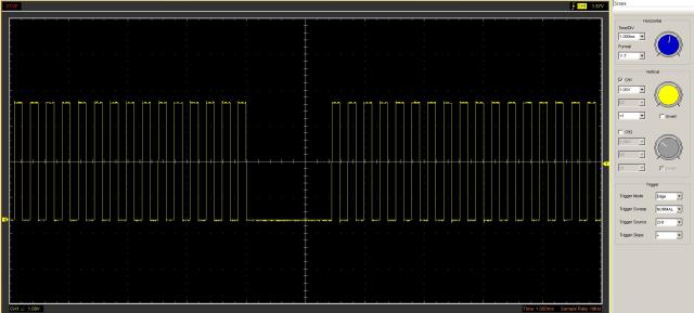

I can see the output stalling. Even this little program will cause it:
PWM 1, 1000, 25
PWM 1, 1001, 25
Each time the output stalls the signal is low (never high) and each time it lasts for 84mS regardless of the PWM frequency. The occurrence appears to be random. SERVO does the same.
This is going to take some serious debugging as it involves the PIC32 hardware and its documentation (the latter is problematical). Leave it with me.

I think that the fix will be to generate a PIC32 interrupt when the timer count wraps back to zero and then update the timer's period register The code is already there for updating the SERVO pulse width. The question will be how much does this load down the CPU.
I used a digital scope running a 10mS/div timebase.

  Quote  Each time the output stalls the signal is low (never high) and each time it lasts for 84mS regardless of the PWM frequency. The occurrence appears to be random. SERVO does the same.
That's great Geoff (errr... figuratively speaking of course)
I really appreciate you're looking into this.
What you have described confirms what I saw happening on PWM and SERVO commands - I put the time at around 90ms, but that's probably my DSO setup.

I've just remembered something and I think I know the cause.
The problem happens when you change the timer compare value to less than the current value of the timer. In this case the timer runs until it hits 0xFFFF and goes back to zero and then continues until it finally reaches the new value before triggering. The solution is to wait in the PWM command until the last cycle completes and then change the values early in the cycle (before the next pulse starts) - no interrupts needed.

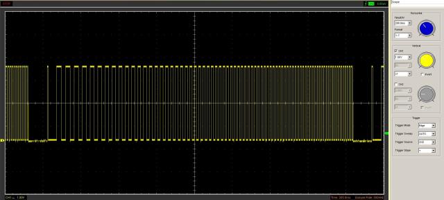

I doubt this will be presented as a 'good coding example', but as a temporary solution this seems to do the trick...
option explicit
dim i, j as integer '<< declares
const min=20 '<< minimum frequency
const max=5000 '<< maximum frequency
setpin 49, inth, PulseInt '<< define the interrupt
i = min '<< Set the initial minimum frequency
j = 0 '<< set a dummy variable
do
pwm 1, min, 50 '<< start the PWM at minimum frequency
do while i < max '<< Have we reached the maximum?
j = j + 1 '<< fill in time while waiting
loop '<< no, wait here
pwm 1, stop '<< Stop the PWM
i = min '<< reset the minimum
j = 0 '<< reset the dummy variable
pause 100 'Wait here and create a trace marker on the DSO
loop '<< do it again
Sub PulseInt '<< do this interrupt
pwm 1, i, 50 '<< set the PWM to the valie of i
i = i + 1 '<< increase i for next frequency
end sub
Simply put, the PWM is setup and run as you would expect, but the difference is that I've looped PWM output to an input declared as an interrupt.
The initial frequency of the PWM is set to minimum and when the output goes high, it triggers the interrupt. Only THEN will the PWM parameters get changed to the next value.
The idea is to write the PWM parameters at a point in time that the PIC can deal with it and it seems to work OK from 20Hz to 5KHz
At least it gives me a smooth ramp up in frequency I can play with
Malibu
Joined: 07/07/2018
Posts: 261
Posted: 09:38pm 01 Aug 2018
Sorry, I meant to put up the resultant waveform...
That's with MIN=20 & MAX=100

Posts: 3370
Posted: 07:29am 05 Aug 2018
I have updated the beta version to fix the PWM gaps issue (it is now at beta 5).
It can be downloaded from: http://geoffg.net/micromite.html#Downloads
Look for "Micromite Firmware V5.04.10 Beta Test Version"
I have done a lot of testing on it and it runs smoothly on both ascending and descending frequencies. Please give it a run and let me know if you find anything else (fingers crossed that that will not happen).

Thanks for the effort you put in Geoff!
I've hammered your new version pretty hard this morning and it's a BIG improvement!
I started off with Ramp Up, Hold Speed, Ramp Down, Hold Speed in a DO: LOOP routine. I kept my eyes on the DSO and it all seemed good, but I could still hear a tiny <clunk> in the motor occasionally.
I figured that it was probably my hardware and/or code that I had, but as I was going glassy-eyed watching the pulses, I THOUGHT that I saw a glitch...
I whittled down the code and ran this...
Const mStep=48, mDirection=50, mEnable=54 <<- Set Constants
SetPin 50, dout <<-- Set Pins
SetPin 51, dout
SetPin 52, dout
SetPin 53, dout
SetPin 54, dout
Pin(mDirection)=Low <<-- CW Rotation
Pin(mEnable)=High <<-- Enable DRV882
Port (51,3)= &B101 <<-- Set to 1/32 Mode
do
for i = 20 to 25000
pwm 1, i, 50
pause 1
next i
loop
Most is to setup the DRV8825 board and I have limited the mode to 1/32 micro-stepping. I've also upped the PWM frequency to 25K, but that's because I've set 1/32 mode.
I kept my eyes glued to the DSO, ready to pounce on the pause icon and finally here's the capture I got.
This is at around 3.7Khz and 1.45mS wide, but I've also captured 1.3mS at various other frequencies too
Again, there seems to be no set pattern or frequency for the gap. Edit: Again, only low, never highs.
With my USB DSO, it could be a limitation of that setup. It could also be my hardware/code, so I'll keep going and see where it ends up.
No doubt, a big improvement on what was prior with a much smoother and sweeter sounding stepper motor.
Edited by Malibu 2018-08-07

A little more...
Here's the code - an adaption of your test code Geoff
PWM 1, 3000, 25
PWM 1, 3010, 25
That should be (3000/200PPR)*60 = 900RPM... confirmed by the digital tacho.
While I run the code, the motor goes crazy by stopping, starting, hunt forward, run reverse, stop, hunt backward... and so on (It's hard to explain, but it does what motors shouldn't do!)
So, clicking ^C in MMchat, will do one of two things:
1) the Motor runs perfectly sweet.
2) the Motor squeals in a stalled position.
Whichever one happens, the frequency continues smooth and steady at 3Khz and physically, the motor runs according to what it was doing when I actually click ^C.
Still fiddling - I'll keep you updated!
