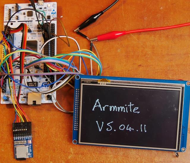

Please find attached V5.4.11
2018-06-17_020552_Armmite.zip
This release implements touch and 3 separate SPI channels. GUI functionality is tested and appears to work properly. VAR SAVE, VAR RESTORE and VAR CLEAR also now work. NB space available for save variables is 128Kbyte.
OPTION BAUDRATE and OPTION PIN now also working.

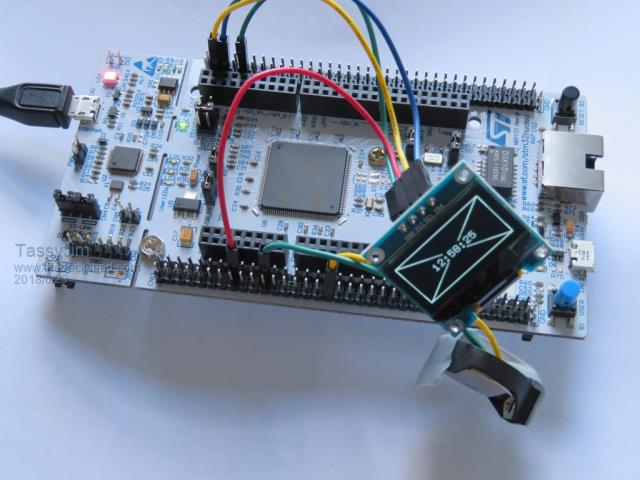

This implements I2C and a RTC
2018-06-17_213858_Armmite.zip
The RTC uses the STM32H7 internal RTC which is wired with a 32KHz crystal on the Nucleo PCB. As delivered the clock battery connection is direct to VCC. However, this can be disconnected by removing the zero ohm resistor at SB156 on the back of the board. Then connect a 3 volt battery between VBAT and GND. The VBAT pin is on the outer row near to the Arduino A3 pin. Connecting VBAT means that an external RTC chip is completely unnecessary.
You can see in the picture the small battery I am using and the rough location of the connections.The software is written to automatically load the time from the clock when it powers up or is reset. The clock can be set using the normal.
RTC SETTIME year, month, day, hour, minute, second {,day_of_week}
Note the new optional "day_of_week" parameter this can be set between 1 and 7 for Monday to Sunday. The day of week can be interrogated with a new function "DAY$" this will return the one of "Monday","Tuesday","Wednesday","Thursday","Friday","Saturday","Sunday" as applicable.
You can re-load the Micromite internal time from the RTC at any time by using
RTC GETTIME
I2C commands are as per the Micromite except that the I2C pins are dedicated and not available for other use
Pins are (see picture for rough location)
I2C_SCL 69 //PB10
I2C_SDA 70 //PB11
You should use the normal "I2C OPEN" command to set up the speed of the port and the timeout.
NB valid speeds are limited to 100, 400, and 1000. Other speeds will be rejected.
I've tested I2C with a BMP180 using the attached program which works perfectly without any change from running on the MM2.

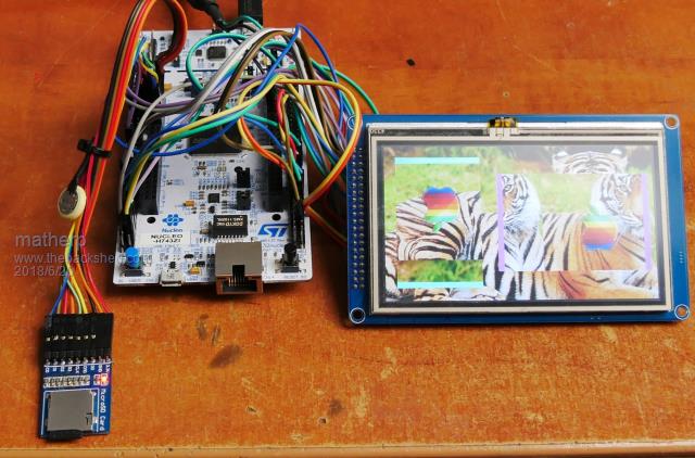

This implements ILI9341, ILI9481, ST7735, ILI9163, ILI9431-parallel and user Basic displays. MMX sprite functionality is fully implemented. See
the video for my example program running.
See the MMX manual for details of the commands.
ILI9481, ILI9341, ILI9341_16 and SSD1963_4_16 are now implemented using an in-memory buffer which does not affect the 498K available for the user. This allows all sprite, blit and transparent text functionality to work on these displays extremely efficiently.
An additional option is implemented
OPTION FLASHPAGES n
n can be between 1 and 4. This sets the number of 128K segments of flash available for the user program. Default is 4 (512K) but reducing this improves speed for loading programs and executing NEW commands. With FLASHPAGES set to 1 the MEMORY command will show 256K (128K for the program and 128K for saved variable usage)
Demo code:
2018-06-20_192320_apple.zip

Posted: 03:16am 23 Jun 2018
I have successfully run the SSD1306 Basic Driver.
There were only a few minor changes to Peters original code.
I used FONT 1 instead of a loaded font and changed the syntax of the ON ERROR SKIP lines.
Together with the RTC, I now have another clock.
I might try a bigger display next.
