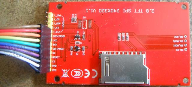

Can we assume that this is your LCD display:
I would be wanting to DISCONNECT the LED line at this point, and then connect it directly to 5v via a resistor - 100 ohms will do for now.
Run your GUI TEST LCD DISPLAY command, and leave it running.
Change the value of the resistor on the LED line up and down, but don't go below about 33R or you might hurt the backlight. The more resistance you put in series with the LED line, the dimmer the display should get.
What this test does, is just remove the PWM drive from the LED line totally, so you can see what's going on there.
Personally, I suspect that the PWM output signal from the MM's BACKLIGHT command, is not working - although you say it does, so something does not make sense here....
I don't suppose you happen to have a logic analyser do you?
EDIT: My photo shows that U2 - the XPT2046 touch controller chip - is not installed, so you can ignore that fact. We're only interested in the LCD and it's backlight for the moment. Edited by Grogster 2018-02-23

Posted: 05:09am 22 Feb 2018
@Grogster
That is the same the LCD I have with me at the moment (working on location).
His panel only has 1 transistor.
I agree with your suggestions and also that something does not make sense.
Seems like an LCD Anode or GND connection issue.
What is confusing is that the LCD Backlight is a backlight to the LCD Display panel. So the brighter the LCD Backlight the brighter the display should be.
