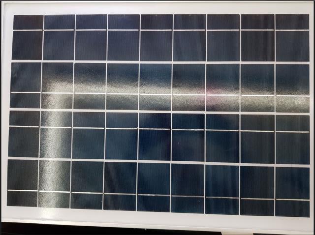

I just went outside with a bulb and meter and with the solar panel laying in the middle of the garden with no shade whatsoever (other than the clouds) it is giving only 23mA of current
Guess I'll have to figure a different way to power itEdited by lew247 2018-01-10

23ma is incredible low. Is the module damaged? And did you short circuit the panel while measuring current?

  MicroBlocks said   23ma is incredible low. Is the module damaged? And did you short circuit the panel while measuring current?
No it wasn't short circuited, it was just the solar panel connected to a bulb via a meter to measure the current
No it's not damaged as far as I can see

For solar panel it is best to measure 'Short Circuit Current'.
Just put your multimeter to measuring current (use the right range) and connect the probes directly to the + and - of the solar panel.
All current will then flow through the meter and this should be higher then 23ma even with just ambient light.
If not then there is probably something wrong with the panel. It said 'module' on your picture, is it only a solar panel or are there integrated electronics?

Just tried that and the result is the same
sorry about the reflection of the lights on the panel, it's inside nowEdited by lew247 2018-01-10

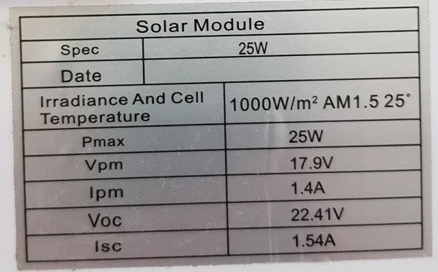

Hi Lew;
A 36 cell, nominally called a silicon 12V PV panel.
Open circuit voltage should be in the 21V - 22V range.
Ok, we have a couple of problems to solve.
1. The measured OCV is about 14V.
This is an odd number.
It's not 1/2 Of 21V, or 10.5-11V, which would have indicated there was a shorted shunt protection diode inside the panel. But yours reads 14V.
If there are 3 shunt protection diodes and one was shorted you would get about 14V.
2. Broken, or open, connection in the panel would, usually, read about 0V.
3. A high resistance connection can cause the voltage reading to be low.
The value of this reading depends on the resistance of the meter.
4. Your short circuit current is 23mA. Whether the panel is outputting 14V or 0V.
That is odd. I would have expected the current would be higher at 0V.
My guess is the panel has a high resistance connection inside the panel. (#3 above).
However this doesn't explain what is happening very well.
Get a new panel!!!!!

A long time ago, when solar panels were expensive, I repaired a faulty panel.
I probed each cell using sharp pins through the protective surface until I found the open circuit cell. I then stripped away enough of the surface to solder a shorting link across the faulty cell.
A bit of silicon sealer and the panel was good enough to go back into service (but not up on the mountain top it came from).
That was when panels were expensive and I was curious about the working of solar panels.
If the panel surface is dirty, clean it, if not, get a new panel.

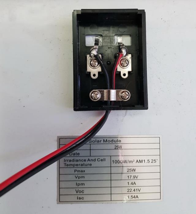

I just bought a 2nd new solar panel
Same thing as the first
only 8 mAh out of this one
Seems like the sun just isn't strong enough on cloudy days in the UK
(most days in winter are cloudy)
Brand new 10W panel this time connected the meter directly across the terminals it should have give around 800mAh - I guess it will in the summer on a good day!Edited by lew247 2018-01-20

  lew247 said   I just bought a 2nd new solar panel
Sounds too suspect; I'd be questioning the meter.
Possibly a blown fuse.
Both my Flukes have fuses on the mA & high current ranges.
Either that or the 20A? shunt has blown loose/became dry jointed.
I can get way is excess of 8mA even as the sun is going down here.
Phil.
Edit,
Try putting the meter briefly across a AA battery; I get an initial 2A, quickly falling to about 200mA (under a second), but could be the meter auto ranging.Edited by Phil23 2018-01-20

The meter works fine
The current coming out of the panel is between 8mAh and 25mAh depending on the amount of clouds

What is the Short Circuit Current in bright sunshine?
