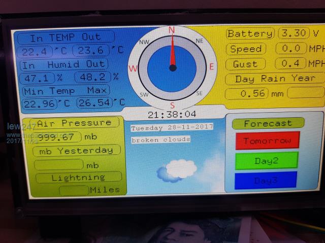

Changing the ICON$ to ICON$ = left$(FieldArray$(2),3)+".ppm" solved the problem, it now appends the .ppm to the icon name and then displays it properly on the tft display
The problem abut the D$ receiving the data twice still exists, I've triple checked and the data coming INTO The com port from the ESP8266 is definitely ONLY Today,broken clouds,04n
this is what print d$ shows
[code]Today,broken clouds,04n
Today,broken clouds,04n[/code]
I can live with it for now as the icon is now displaying properly, however it's really frustrating not knowing why it's doing it

Screen display looks very nice.
