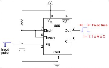

right... after a few hours of further contemplation i have an idea to throw out there to everyone, a possible method of generating both PGC and PGD from just the TxD output of any ttl-level usb to serial bridge.
by setting the serial port to 1Mbps (no parity, 1 stop bit) it looks like we can generate a quite precise 1uS negative-going pulse on TxD by sending chr$(255) out the serial port, and a 10uS pulse by sending chr$(0).
lets take the TxD output and feed this into the trigger input (pin 2) of a LM555 configured as a 5mS monostable oscillator. note that the TxD output idles at logic '1', while the 555's trigger input responds to a falling edge.
if a 1uS trigger pulse is used, the rising edge on the TxD line will coincide with the output of the monostable being '1' (high). if a 10uS pulse is used, the rising edge on the TxD line will coincide with the monostable output being '0' (low).
we therefore just need to connect TxD to PGC as well as the 555's trigger input, and feed the 555's output (pin 3) to PGD via a 3k3 resistor. PGD data can be read back directly on the pin using one of the RS232 port's spare flow control inputs, as has already been well proven.
the LM555 officially runs down to 4.5v, but cmos versions are available that work down to a couple of volts. the trigger input trips at 1/3Vcc, with the device drawing just a few milliamps. i'd in fact expect most regular LM555's to function fine at 3.3v with little issue.
the above should produce a sustained PGD bit rate of 100,000bps. if the port can be set to 5-bits instead of 8, this could be boosted by around 30%. if desired, TxD can also be looped back into RxD, allowing a linux/windows application to count the data going out so as to know when a valid value can be read back from PGD.
comments anyone?

I haven't a clue what accuracy you need,
but t is dependent on the precise values of R & C
A PicAxe might be more accurate ?
Posted: 10:25am 30 Aug 2014
we're looking at two substantially different pulse lengths: 1uS versus 10uS, so the monostable could vary between 2uS and 8uS without causing an issue. the LM555 itself is very stable and timing is independent of temperature and supply voltage variations, while R and C should be within 10% for most off-the-shelf parts over quite a temperature range.
bottom line: a 555 + R + C is unlikely to be any more than 20% off in the worst case, which won't matter at all.
(actually, with no parity, the long pulse will only be 9uS. but that doesn't matter)
rob :-)
addendum 1: the TI datasheet for the 555 states, "In monostable operation, the trigger should be driven high before the end of timing cycle". to achieve this, a suitable RC network will need to be added before the trigger input.
addendum 2: looks like PGD is clocked in/out on the falling edge of PGC. a second simple RC network should suffice to shape the rising edge on TxD into a short pulse to accommodate this.Edited by robert.rozee 2014-09-01

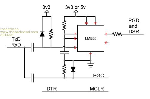

here goes a more complete schematic of what i was talking about earlier:
with the comm port set to 1Mbps, 8 bits, no parity:
1. transmitting chr$(0) should create a 9uS negative-going pulse at TxD and cause a '0' to be clocked out to PGD;
2. transmitting chr$255) should create a 1uS negative-going pulse at TxD, causing a '1' to be clocked out to PGD.
by counting in the character echoed back on RxD, when it is desired to read back from PGD a program just has to pause until count out = count in (ie, for all Tx buffers to empty out), then read back PGD using the DSR input. DTR is used to handle driving the MCLR line as before.
how it works:
TxD idles at '1', and goes to '0' at the start of transmission. how long it stays low depends on the character being trasmitted: 10uS for all zero bits, only 1uS for all one bits (chr$255).
the falling edge passes through the top RC/diode network creating a short pulse. this initiates a 5mS high-going pulse at pin 3 of the LM555. this output is fed into PGD via a 3k3 ressitor so causing PGD to be set to '1' for the first 5uS after TxD goes low, then back to '0' thereafter.
if TxD goes high after 1uS, this rising edge creates a short pulse (via the lower RC/diode network) at PGC. the pulse then clocks in the '1' on PGD. if TxD instead doesn't go high until after 9uS, the clock pulse occurs well after the monostable has reset, and a '0' will be clocked into PGD.
in theory, and assuming that PGD needs to be read back infrequently, this should allow a sustained throughput of around 100,000 PGD bits per second.
i'd be keen for someone to have a play with this circuit. i'd also be interested if anyone using John's software could attach a piezo sounder to PGC and report back what they hear during programming using the FT232R/resistor solution. this will give an idea of what the achieved bitrate is.
rob :-)Edited by robert.rozee 2014-09-02
