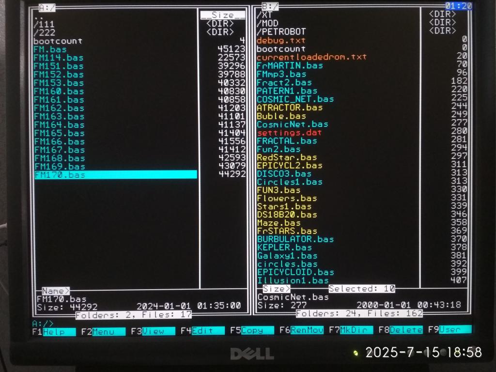

  javavi said  FM v.1.69 For testing!
+ A bunch of minor edits
+ Added display of file sizes on panels
Copying a directory with F5 and move/rename with F6 are buggy. F5 dir copy does not return to the FM but the copy is done. F6 shows a blank page in serial console and nothing happens on local screen.
Left panel does not show a column for file size.
Tested with resolutions 848 and 1280
I cannot see a usecase for the command line, as it does not return to the FM.
What do you use it for?
Edited 2025-07-16 02:29 by dddns

The long-awaited release of File Manager v1.70 from Javavi
FM170.zip
+ Support for all resolutions
+ Switchable panel view (simple wide, with sizes)
+ Added function to search for one file from the current directory.
etc...

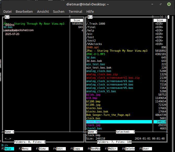

dddns
Joined: 20/09/2024
Posts: 924
Posted: 09:59am 17 Jul 2025
  dddns said  quick&dirty just commented out and defined colours by hand real quick, it runs on a RP2040 and a 7inch LCD ..very nice!
It works in full extent! It works perfect with FONT 1 and 4, all other fonts work as well only the frame is missing. Colours and inverted text work fine as in HDMI. My resolution is 800x480. Your new scaling is solid!
The processing speed is at least as fast as on HDMI and 2350. Very usable!
It looks very nice on a LCD! Pictures are shown in true colour :)

dddns
Joined: 20/09/2024
Posts: 924
Posted: 02:32pm 19 Jul 2025
Hello Javavi,
I'm sure, you remember the wonderful set of subroutines replacing print@ provided by @matherp here
I _only_ replaced all COLOR commands by calling this subroutine:
Sub setcolour f%, b% ' set the colour of both the screen and the console
Local integer fr=f%>>16,br=b%>>16,fg=(f%>>8) And &HFF,bg=(b%>>8) And &HFF,fb=f% And &HFF,bb=b% And &HFF
Option console serial
Print Chr$(27)+"[38;2;"+Str$(fr)+";"+Str$(fg)+";"+Str$(fb)+"m";
Print Chr$(27)+"[48;2;"+Str$(br)+";"+Str$(bg)+";"+Str$(bb)+"m";
Option console both
Colour f%,b%
It was not more than find&replace and took 15min..:
So I can say, that it runs for me on every platform ..very very nice!
Edited 2025-07-20 01:07 by dddns
