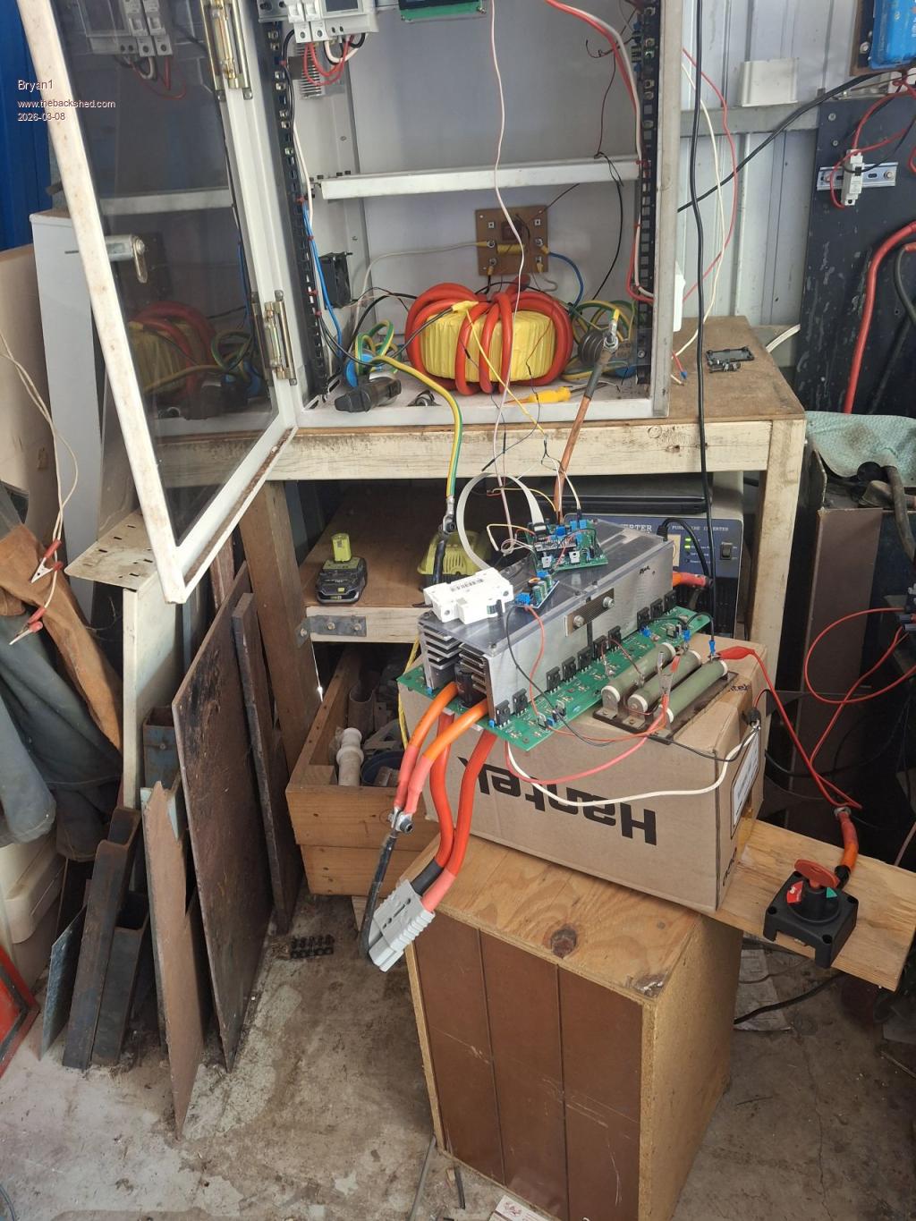

Well got every setup the way it was before
Now I have changed out R54 for 1K and soldered in a short for the 120 ohm resistor so those changes have happened.

Bryan1
Joined: 22/02/2006
Posts: 2297
Posted: 03:28am 08 Mar 2026
Well just tried it out and I made an inline switch to supply VBat, so once the BV got to the voltage of the psu I closed the switch then turned on the nano.
It dropped to 10 volts with only 1.7 AC volts at VS1 and VS2
Now measured those fast diodes when was running now the one where the arrows pointed on the left was 17 volts and the other one 7 volts.
Now the TIP31 pins were 8 volts 9 volts 8 volts
I did do a test with the choke cables left off and the result was the same 1.7 AC volts so yes the problem looks to be in the power board.
Edited 2026-03-08 13:36 by Bryan1

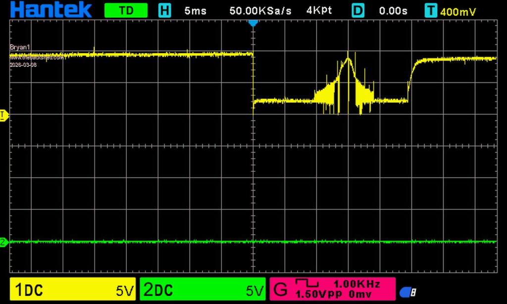

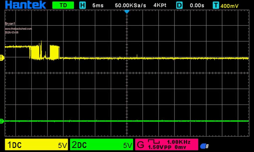

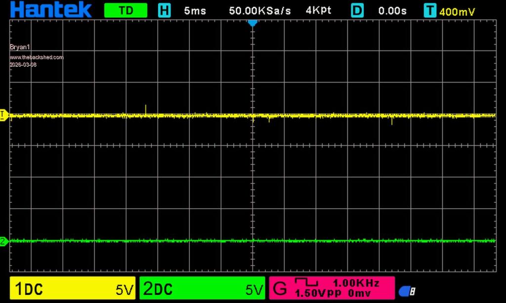

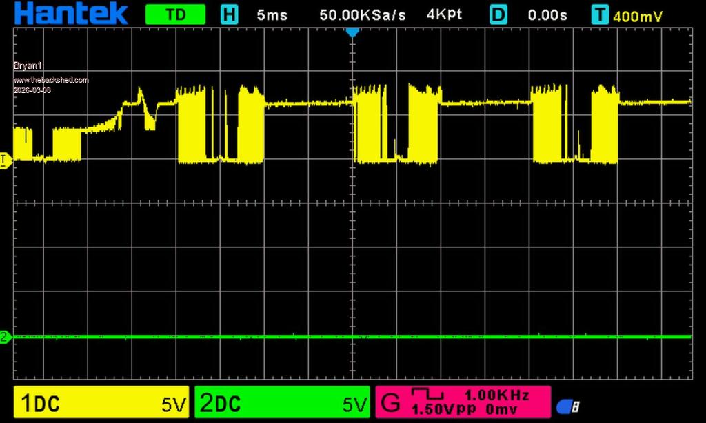

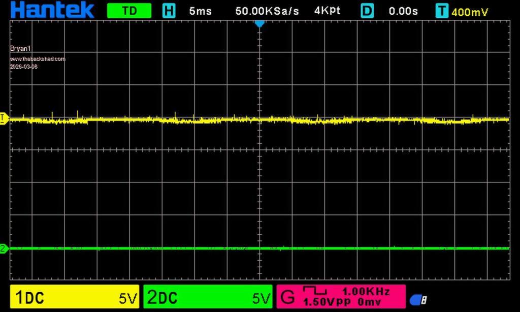

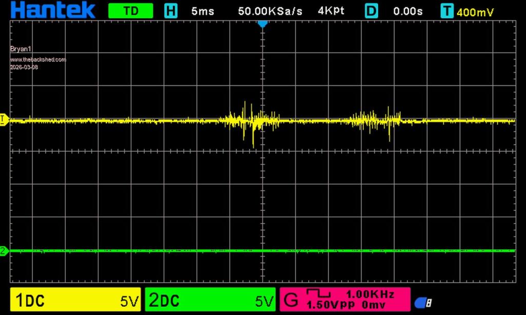

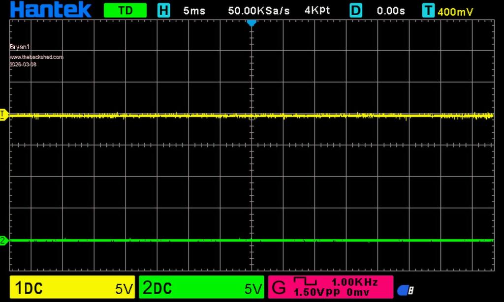

Verify that D1, D7, D18, and D19 are at the corners of the PCB.
If they are, use your scope CH1 probe and do the following VERY CAREFULLY:
1. probe GND to power board ground probe tip to D1. capture and post scope screen.
2. probe GND to power board ground probe tip to D7. capture and post scope screen.
3. probe GND to power board VS1 probe tip to D18. capture and post scope screen.
4. probe GND to power board VS2 probe tip to D19. capture and post scope screen.
Bryan1
Joined: 22/02/2006
Posts: 2297
Posted: 04:06am 08 Mar 2026
Ok got some scope pic's but it does help to read properly as I probed D1,D7,D18,D19 with gnd going to vbat ground
D1
D7
D18
D19
Now I will go and 3 and 4 like I should of.

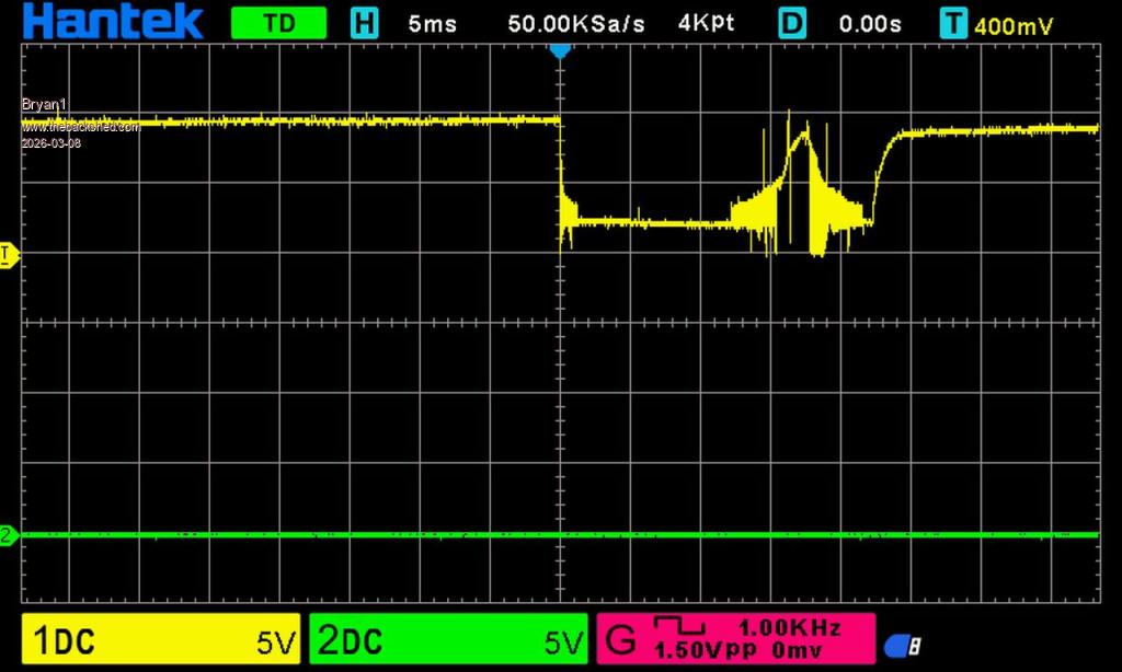

Bryan1
Joined: 22/02/2006
Posts: 2297
Posted: 04:20am 08 Mar 2026
3.
4.
tinyt

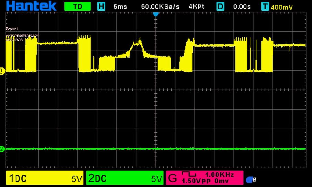

OK got some scope pic's of the gate on each leg
Gate of Q3
Gate of Q14
Gate of Q25
Gate of Q19
R1, R26, R27 and R52 all measure 20 ohms
tinyt
Joined: 12/11/2017
Posts: 564
Posted: 05:02am 08 Mar 2026
Looks like Q3 - Q8 mosfets are receiving the right gate signals.
