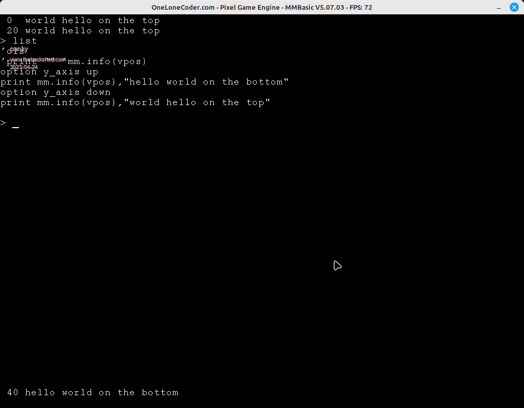

Is this a bug in MMBW 5.07.03b15?
When OPTION Y_AXIS UP is in effect, PRINT does nothing.
option y_axis up
print"Won't see this"
option y_axis down
print"This is OK"

  toml_12953 said  Is this a bug in MMBW 5.07.03b15?
option y_axis up
option y_axis down
print"This is OK"
Tom,
Not sure on b15 but on b16, works as it should with the following options
> option list
OPTION Default mode 9 1024x768
OPTION Default Font 2,1
OPTION Default path C:\MMB4W\work\
OPTION Keyboard US
Current display 38,85
Regards,Doug.

OK, I found b16 but I still get no printing while OPTION Y_AXIS UP is in effect. I used the same options as in your list to test it.

@toml_12953
Not sure what is going on mate - works for me on both Win 11 laptop and Linux Mint 20.1 under wine to a large screen monitor.
Anyone else seeing this? Any ideas for Tom?

I only see the second line. I should see both.
You see this? This is what it should look like:
Won't see this
This is OK

I think I see what the problem may be.
If you add CLS as the first line of your program above, the bottom line does not print. If you then add a PRINT command on line 2, right after the CLS it prints as it should.
It appears that CLS does something wierd?
At the prompt enter CLS:RUN - the problem is there,
enter just RUN, everything works (on both my Windows and Linux machines).
This might be one for Peter unless I am missing something obvious (ALWAYS possible ).
It works OK for me. Note that the "You wont see this" is at the bottom of the screen.
Try MODE 1 for an 800*600 screen to ensure that its not just that your last line is not visible. Check your have not scaled the font above 100% in windows settings if the bottom line is not visible.
